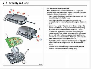

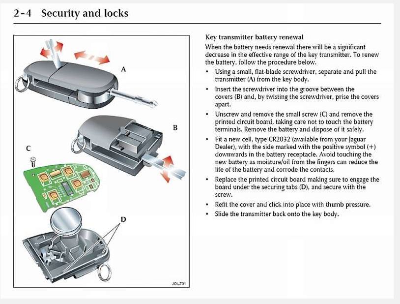

Most likely the contacts on the circuit board in the fob is dirty. Take the fob apart and clean the board contacts and the fob contacts with electronic cleaner or alcohol. Below is how to open the fob.
