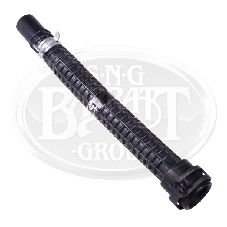

The PCV hose is smooth all around, however, it does have a couple of "seams" that I see/feel. Does it come that way? Also, the "football" piece doesn't appear cracked or crumbled to me and the only rub off seems like dust. Lots of dust under here!!!

Your car has the old style PCV hose. Part number for upgraded hose is C2S40863, obtainable from local Jag dealer or online. I got the picture from site sponsor SNG Barratt; they'll send you a printed catalog on request, which is handy for researching most parts.
