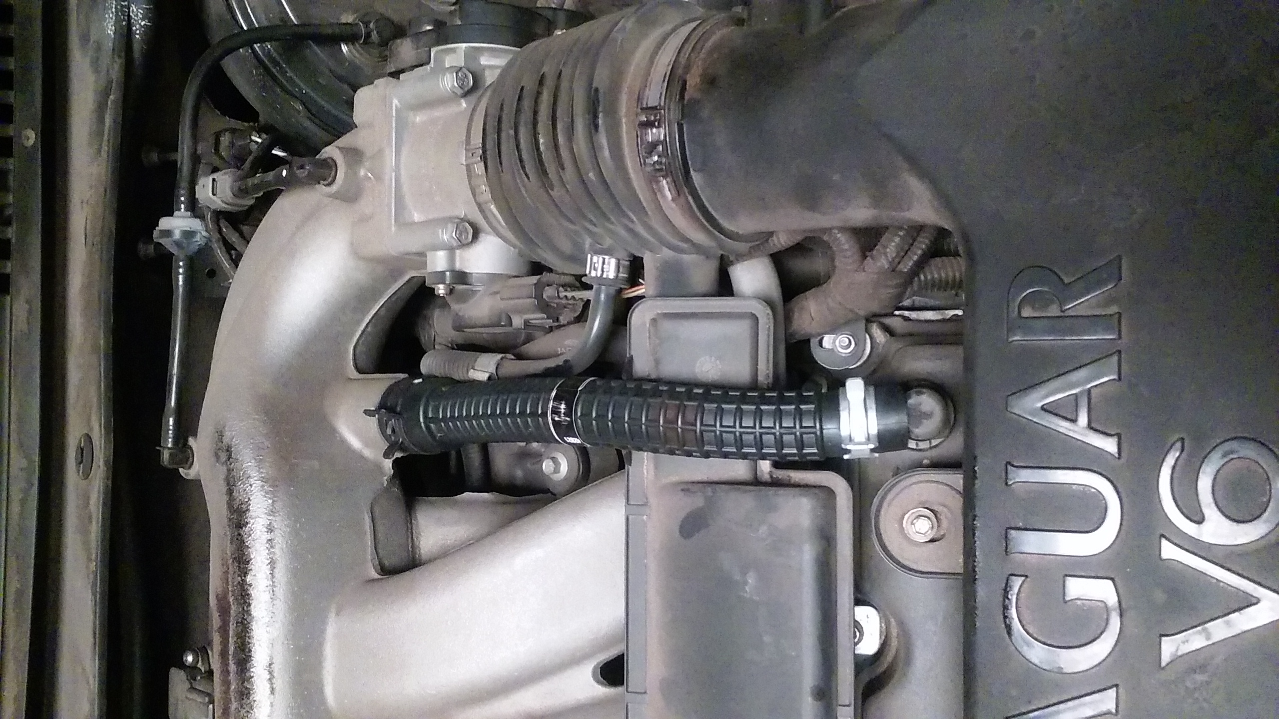

Hello Everyone and Happy New Year!!!!!!
Here's an update. I had the Crankcase Vent Hose put on and had the smoke test done when I took her in for an oil change. The smoke test revealed no leak and the check engine light is still on, although it did go off at 1/4 tank of the last fill. So, I'm still working on it!!!

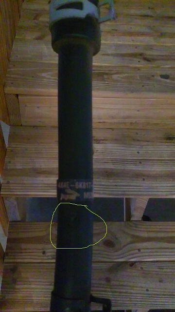

Was the check engine light on when you changed the hose and since then it has still not gone out? Or did the light come on after you changed the hose? If it was on before the change it might takes some time before it goes out as you need to meet a certain number of driving cycles without the issue present before the light will go out. If the light came on after the change the new easiest things would be the IMT o-rings and the brake booster. Both cheap and easy fixes.
When you changed that hose how did the bottom look? Were there any splits in it, especially on the bottom?

Alfadude,
Yes, the check engine light was on prior to the hose being changed on the 31st. I see one blemish on the bottom of the hose. Hopefully, you can see it.

Was there a crack in the hose, making for an air leak? That's what we'd like to know.

The smoke test was done while the old part was on, it revealed no leak. Although, the part does have some small blemish on the bottom, it's definitely not a crack. So, no.

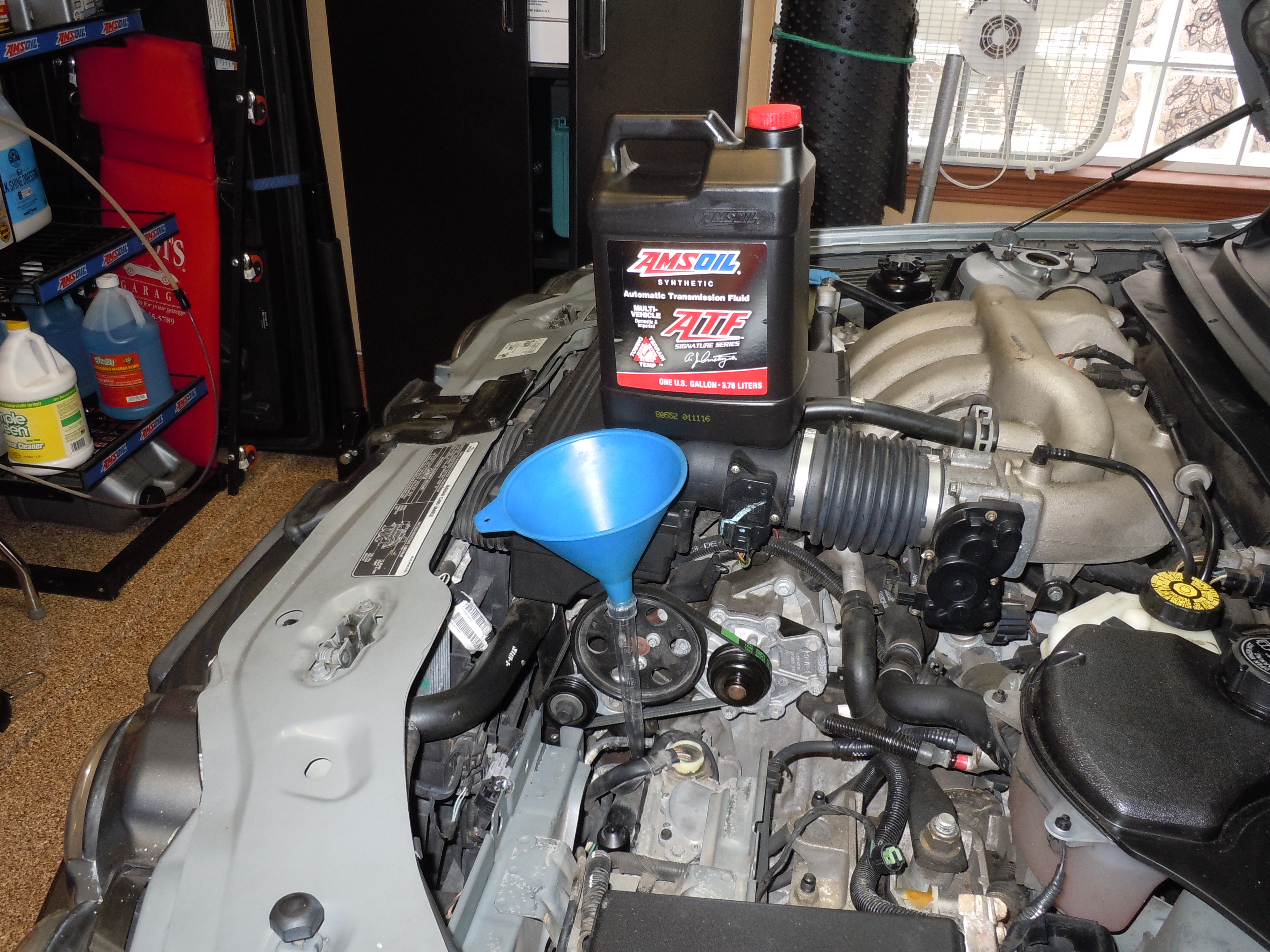

Sarah, let's review the bidding shall we? You've got codes P0171 and P0714, which mean you've got an air leak downstream of the mass airflow sensor (MAF) affecting both banks of cylinders. In the picture look to the right of the blue funnel. The MAF is the rectangular box with blue paint slash on it mounted in the air intake boot. Your air leak is somewhere to the right (downstream) of the MAF. I'd start with a very thorough inspection of the ribbed intake boot adjacent to the MAF - especially since both banks are showing lean. To me that's the key fact - both banks. It could be something as simple as a crack in that boot or a loose clamp. Your codes are "generic," meaning that they apply to all car manufacturers; they are not Jaguar-specific. A competent shop will know how to find and fix the leak(s). I suggest you do a net search for "jaguar repair shop houston," then make a list of the shops. Then see if you can find some reviews of those shops. That may lead you to one that can help you.
