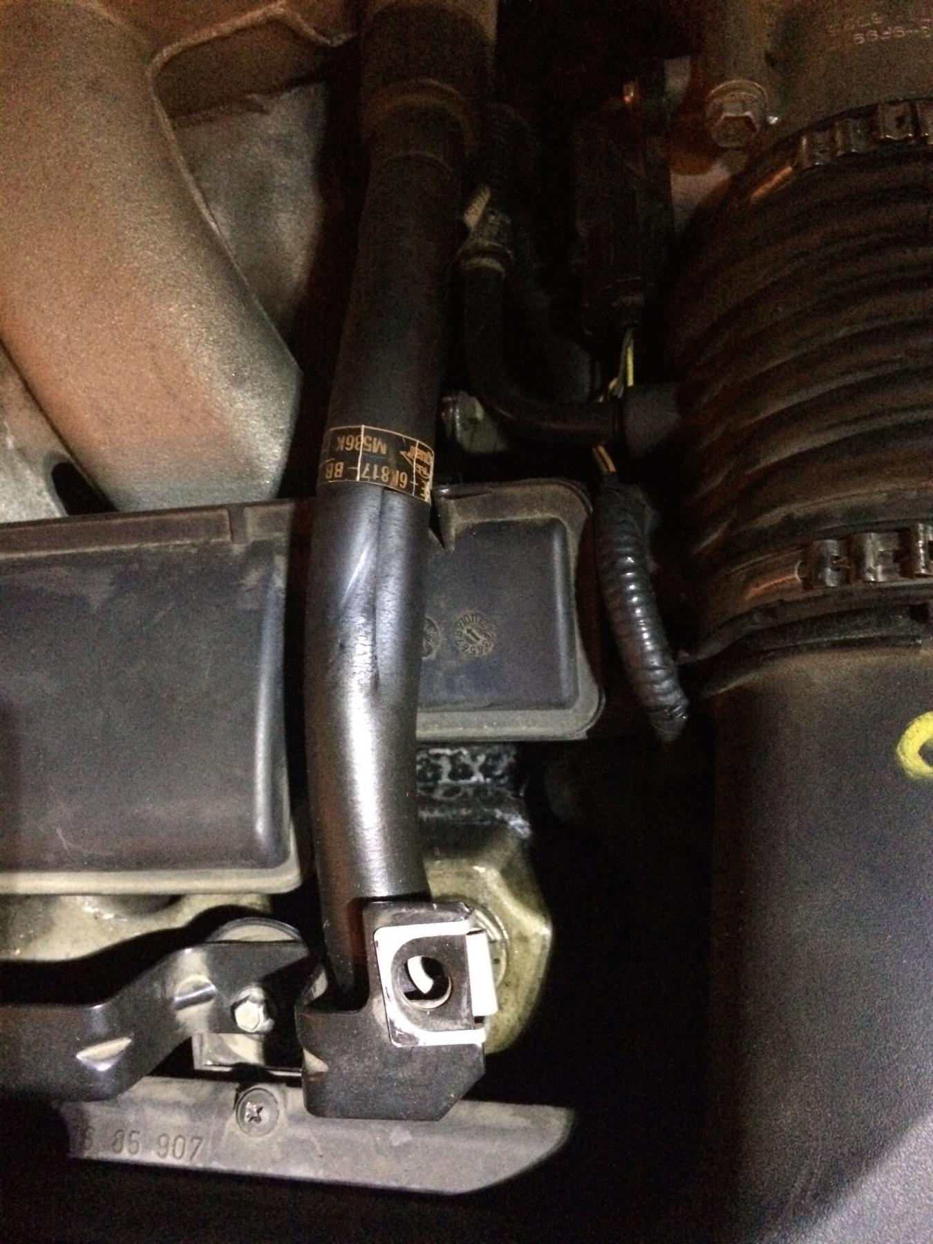

Sorry for the delay but here is the result of all those codes:
After spending $ on fuel injectors and ignition coils the real problem was the breather hose. I can't stress enough how many times I checked that thing but never noticed it being cracked. I attached a picture for better view. By the way, the hose is ripped a lot more than when I discovered it the first time. So all codes have been removed and car drives without any problems.
You can obtain silicone hoses as direct replacements for these items. A much better long term bet.
