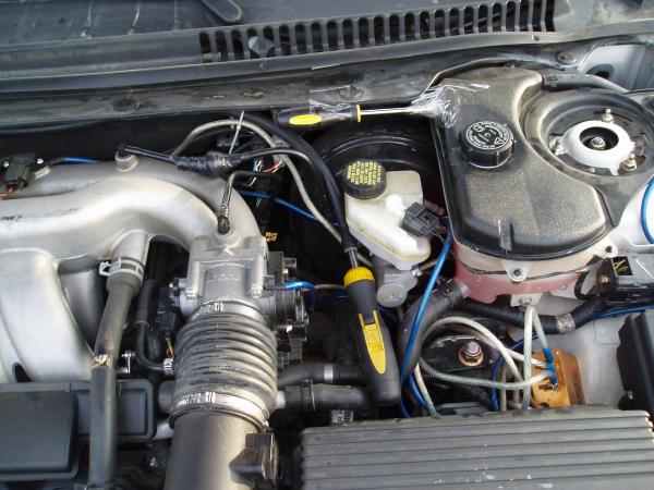

Thought you guys would get a kick out this. It drives fine though! Hopefully getting the new coolant tank tomorrow.

Is that a fuel saving mod or a performance mod?

Haha... I got the new coolant tank today and installation was actually painless. Drained the coolant, disconnected the tank's hoses, unbolted it and put the new one in its place. Filled it back up with some flush solution and going to do the deep flush in case the previous owner hadn't kept up with the coolant maintenance which is easy to forget. Car seems to be running a lot smoother and cooler and back to its old self again! (Just waiting on a new booster hose and it'll be all back to normal again)... Noticed the car had a few drips of oil underneath the engine. I was not aware of it leaking oil, but with the plastic cover off under the bumper, I could see some drips collecting.
PS The new coolant tank has metal reinforced hose nipples, so it looks like they improved the design of the oem tank. Also the new cap is much easier to remove.

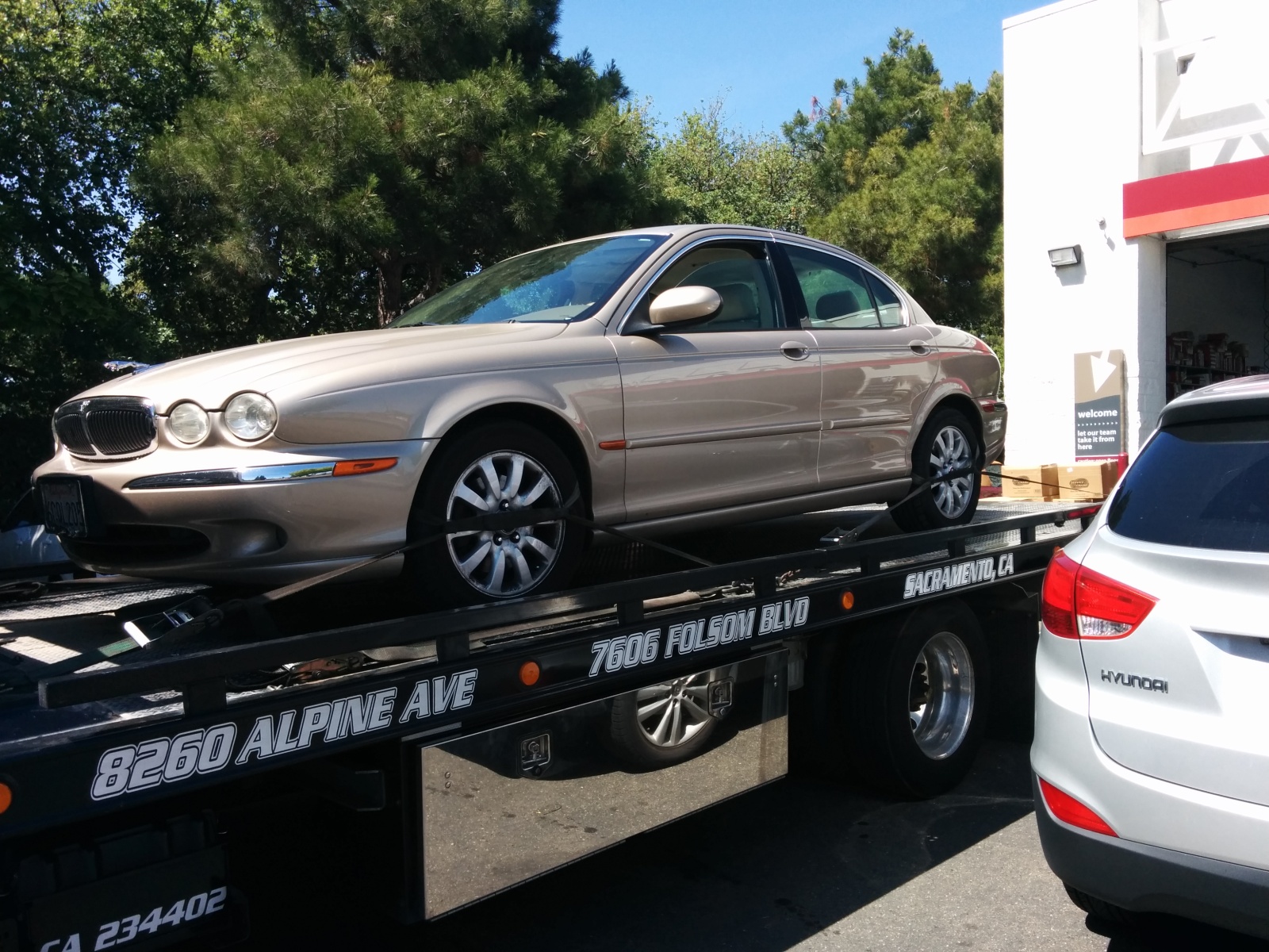

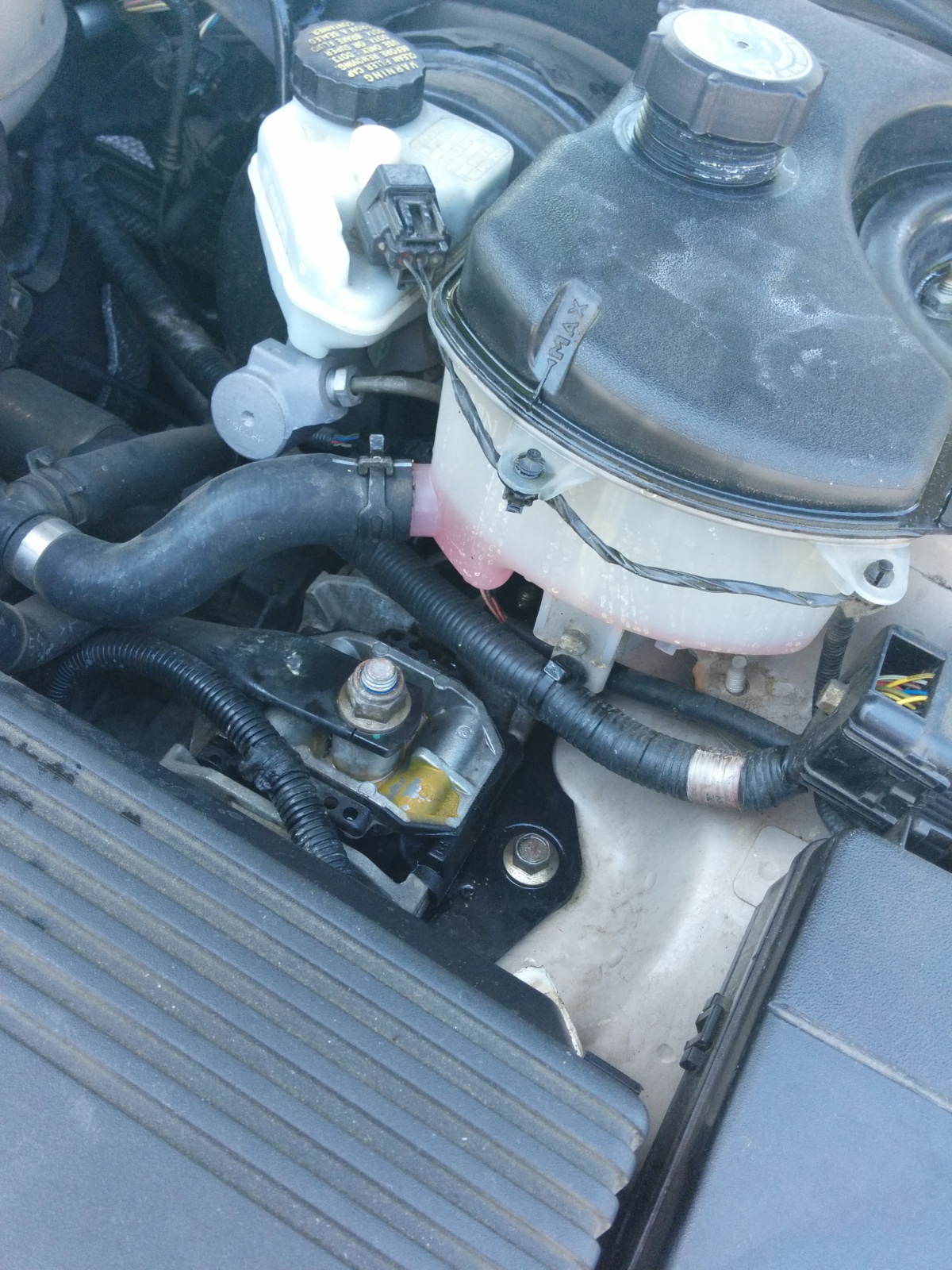

Had the same issue happen to me yesterday.
I took it to Jiffy Lube to get it fixed.
Attached Thumbnails  Coolant tank failure-vg0q4x.jpg    Coolant tank failure-o8t17t.jpg
