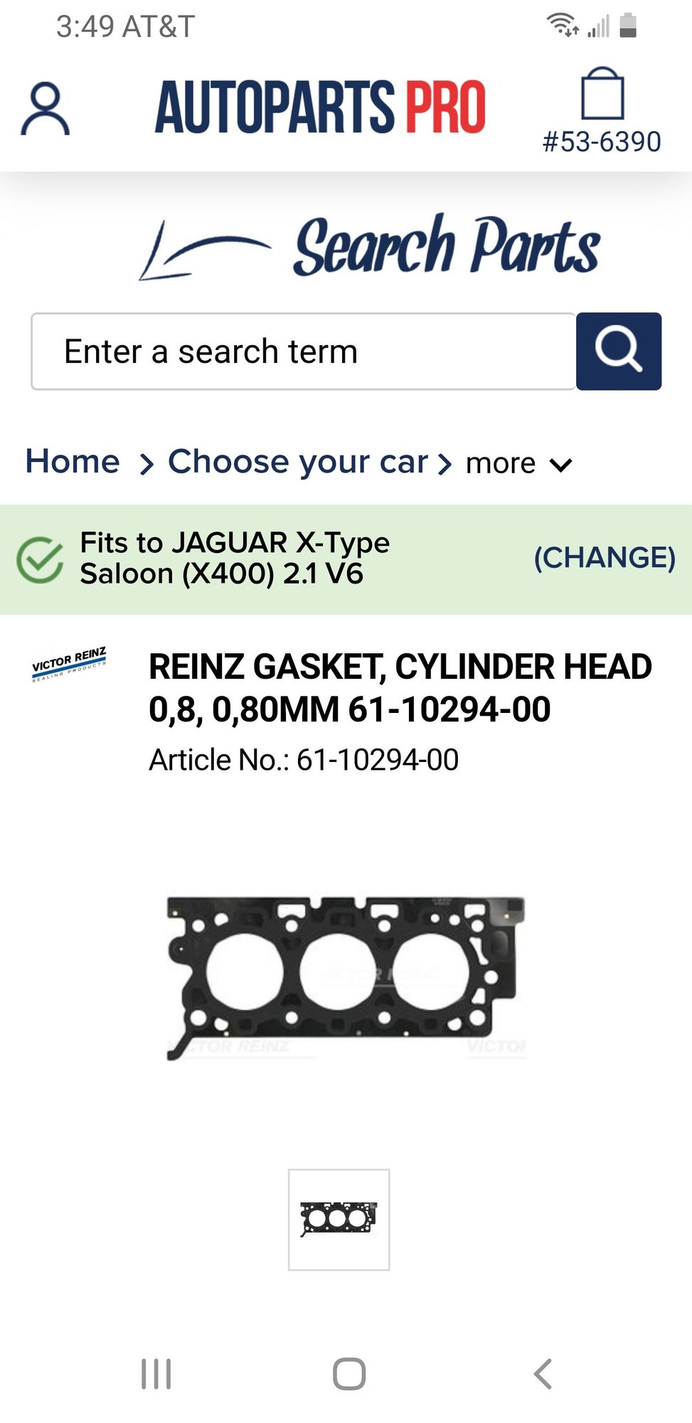

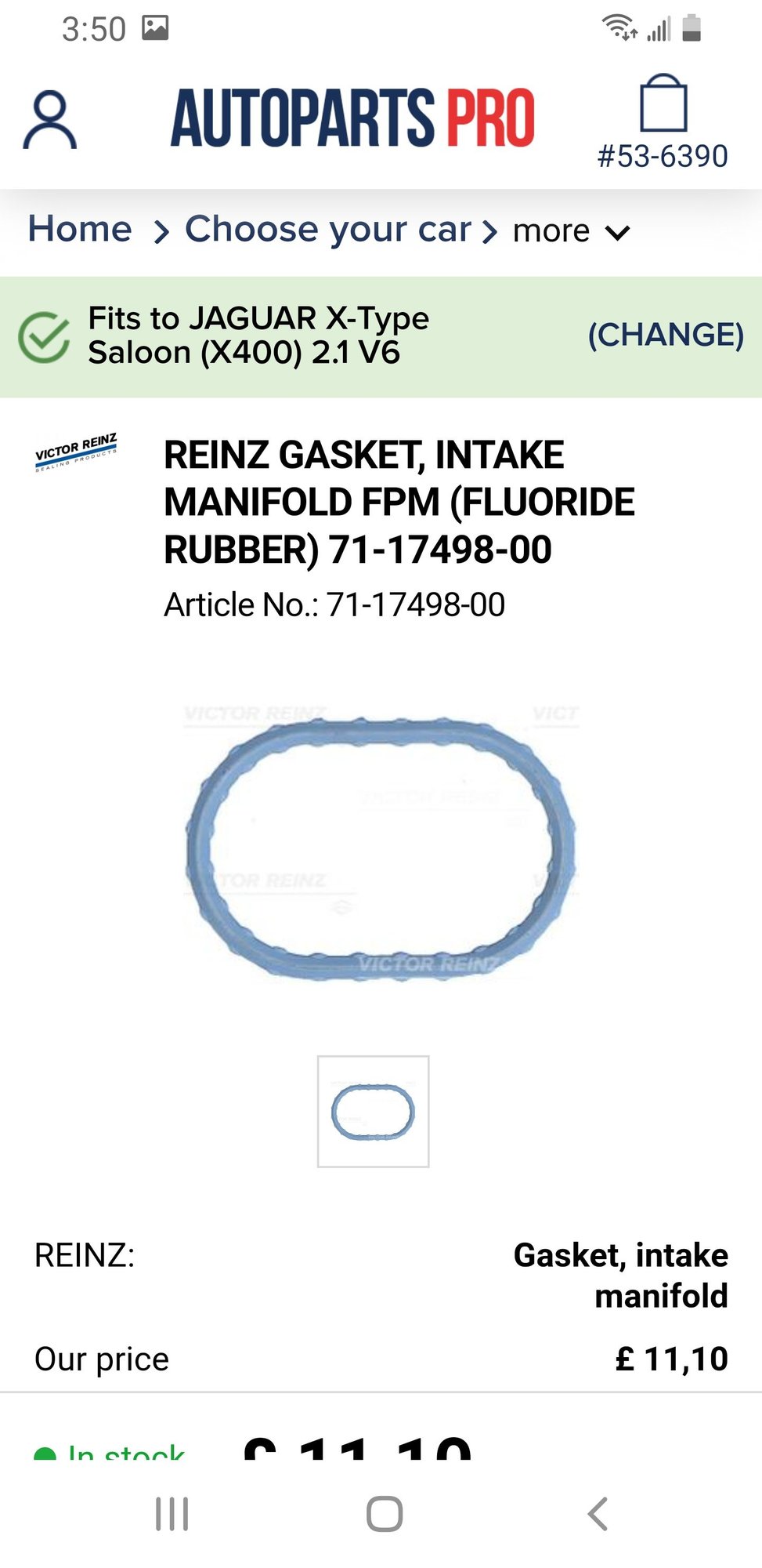

I don't mind replacing the rocker box and spark plug well gaskets but I can't find a lot of references for the 2.1 for these bits
Do they use the same gaskets as the 2.5 and 3?
If not , any hints on where to get them?

No
These guys may carry them for you in Australia
https://www.sparesbox.com.au/part/pe...et-set-dx060hs

Thanks for the confirmation Dell. I stopped trying to look for parts from the chain stores and searched for an independent guy and found a crew called Cathouse Spares. Had them in stock, for a more than reasonable price. Took a drive and now have rocker cover and spark plug well gaskets in my hand. Just waiting on the new coils and we're away. Would have liked intakes but none left, apparently supply chain affected.
