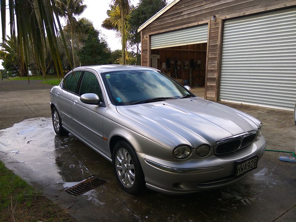

I'm sure I'll be bringing up more questions as I get along. The car is absolutely wonderful to drive, it handles like a dream and has quite the get up and go for overtaking.
Here's a picture of it - it's in mint condition:

Sorry, here's the image:

Car looks GREAT...You will love the new car....I know i do

Very nice jag, I've got the same year and colour, but 3.0 manual.
Surely not in such perfect condition, though (but not bad either)

Fancy car

There should be a hood ornament on it, why is it not there? Put it back on and you should get a nice increase in fuel mileage, it is very important in the aerodynamic design of this model.
Nice looking for sure, hope it is trouble free. I got mine from a police auction, drug seizure. It sat for over 3 years in impound, needed only a battery to drive. I did eventually replace the intake gaskets and IMT o-rings but they never were an issue, just a routine thing. So IMO you should be fine.
