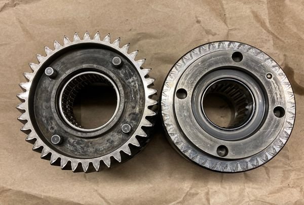

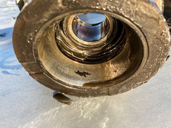

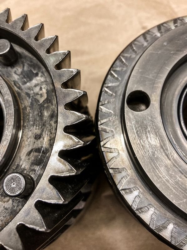

The earlier ones I have looked at have a viscous coupling, and there is a slight bit of movement between the coupling and the mating gear, that creates wear patterns of the teeth and metal shavings. The coupling and gear sit on dowel pins and there is a slight bit of movement between them.
The pinion bearings also have a high preload, probably too high. Here is one bearing race that started to spall apart under the load.
