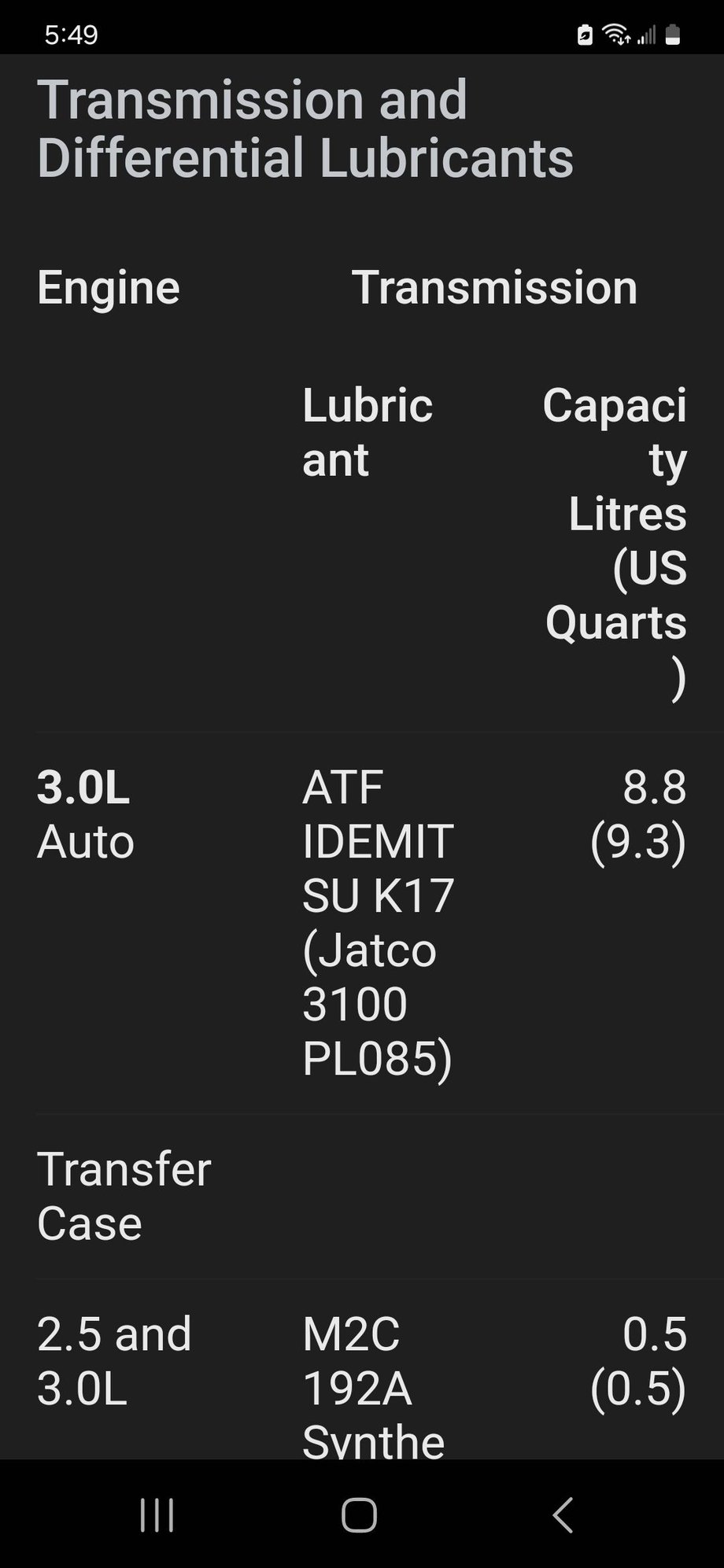

Peter, I like this idea of yours, but can I ask where you found the gearbox capacity figure of 7.7 litres. All the relevant Jaguar documentation that I have agrees on a figure of 8.8 litres which is quite a difference when you're trying to specify definitive dipstick dimensions for the rest of us.

So, thanks for your input. I checked and you seem to be right. I just had the figure of 7.7L in my mind.
I also double-checked what I wrote in my other thread, the ATF full flush, where I was able to remove 7.9L, but as someone back then correctly stated, I would not be able to empty the torque converter that way, this leads again to the conclusion: Yes, 8.8L in total.
