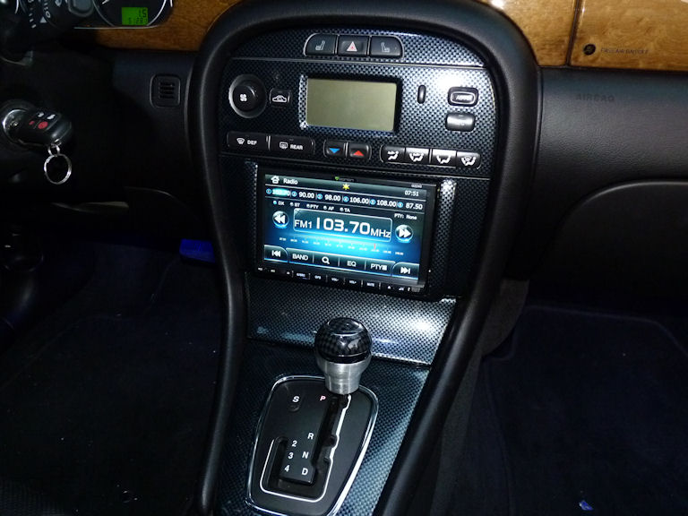

Default my install
Thought I'd post this even though this is pretty old thread now. I'm sure people still bump into it searching about stereo install, i know i did.
https://www.jaguarforums.com/forum/x-type-14/customizing-xtype-help-others-101568/#post801746
