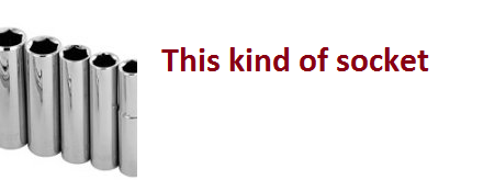

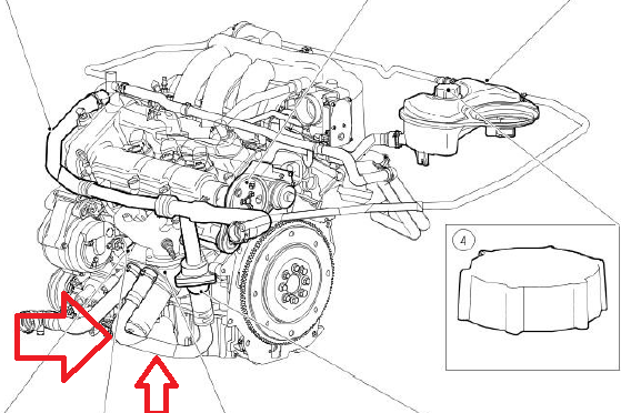

It was a freak accident, call me idiot if that makes you happy but i dropped 8mm deep socket into this hose under thermostat which connects to engine oil cooler
I need to get my baby smogged asap and thermostat was the last one in the list, i replaced it and socket got stuck and then fall right into the hose :-(
I want to know, what is the worse which can happen ??
Can I drive it and get it smogged and remove this socket in few days ??
Can i use a magnet ? if so which kind ??
Any help appreciated

Can't you just disconnect that hose at each end and retrieve the socket. Sure you will have to replace some coolant. Can you get a small but strong magnet and tie to a string to fish out the socket with?

A deep socket couldn't have made a 90 degree turn. Can't you fish it out with a bent coat hanger, long needle nose pliers, hemostats, etc.?

Thanks for replies
i wanted to disconnect from other end but i cudnt find my ways without having to remove oil filter
hangers and other stuff wont go in since i am underneath the hose and its tight space 😖
I will try to fish using a flex magnet, i was wondering it its safe to drive so i can get it smogged

I have an old 'telescoping' magnet that I cut the magnet tip from. I soldered a section of #12 gauge copper wire so it will bend anywhere I need it to.
Just an idea.

What if you got a strong magnet and held it against the pipe and try to get the socket to follow it up to the top so you can grab it.

Made a trip to auto zone, found flex magnet
I was easier than I thought p0116 and p0117 was gone:-)
Thanks for all suggestions
