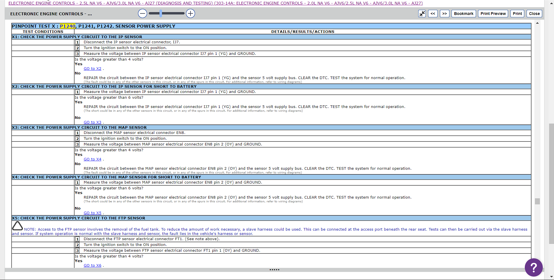

btw I still got the p1240 code and on identifix its telling me to do these pinpoints which does led me to do the gas tank, but the note says smt to make it easier I am not sure what its saying to do
should I do these test if so which is the IP and FTP connecter
