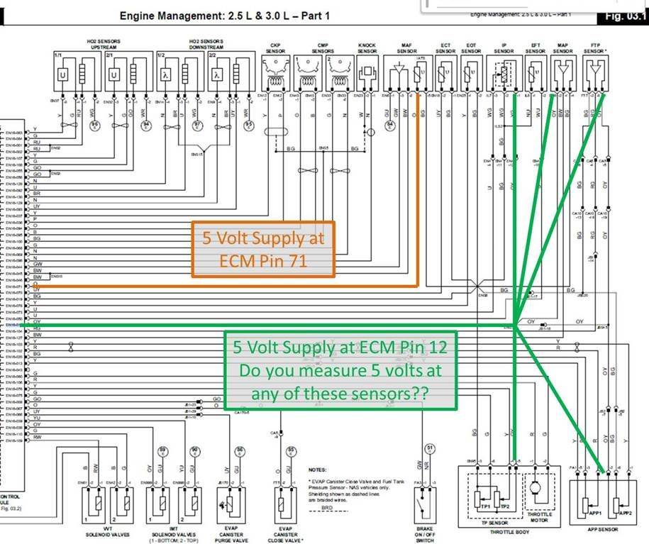

Originally Posted by dh53
Your current codes/issues point to at least the MAF and fuel pressure (aka IP sensor) sensors. As thermo and xalty mentioned there is a 5v reference signal to several sensors. Are any of the sensors getting a 5 volt supply signal? If that 5 V is not coming out of the ECM you would get a lot of sensor codes.
That 5 volt sensor supply out of the ECM has been mentioned a few times previously. From your video I see there is something wrong. That yellow/green wire at pin 1 should be 5.0 volts. My Jag Workshop Manual says between 4.5 and 5.5 is acceptable. In my experience sensor supplies are typically very very close to 5.0 volts.
At the end of the video it looks like you are reading the pinpoint test for the 3 pin MAP sensor but testing the 5 pin MAF sensor. My manual says that power wire to MAF should be orange, exactly as you found. You measure 4.99 volts so that is perfect. BUT, the MAF and the fuel pressure sensors operate on 2 separate 5 volt supplies. The fuel pressure sensor gets 5 volts from the same supply that goes to the MAP sensor, throttle position sensor, pedal position sensor, and fuel tank pressure sensor.
I think you have one of 3 problems here. Either the ECM is not putting out 5 volts, one of the wires to the 5 sensors is shorted to ground bringing the whole 5 volt supply down, or one of the sensors is shorted. I would unplug all 5 of those sensors and check for 5 volts at all of them. If you don't have 5 volts measure the resistance to ground from each of those 5 connectors where you are supposed to have power. One is likely to have near zero resistance because it is shorted to ground.
If you do get 5 volts at all of the connectors I would plug one connector back in and check for 5 volts on the others. Then plug in the next sensor and repeat. In that way you can narrow down which branch is the problem.
For example, say you have 5 sensors disconnected and measure 5 volts on each. Your power supply is good. You plug in the fuel tank pressure sensor and you still measure 5 volts on the fuel pressure sensor, everything is good. Then you plug in the pedal position sensor and you no longer have 5 volts at the fuel pressure sensor. Now you know the problem is with the pedal position sensor because plugging it in shorts the whole 5 volt supply.
Standard disclaimer: I am looking at a manual and wiring diagrams for my 2005 model year, not for your car.
Old May 16, 2024 | 02:15 PM
  #178
HELP's Avatar
Joined: Apr 2023
Posts: 270
From: vancouver

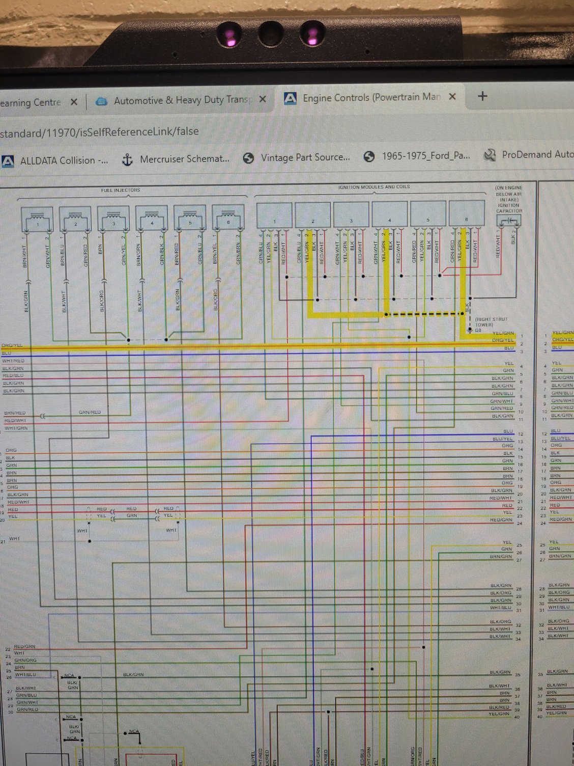

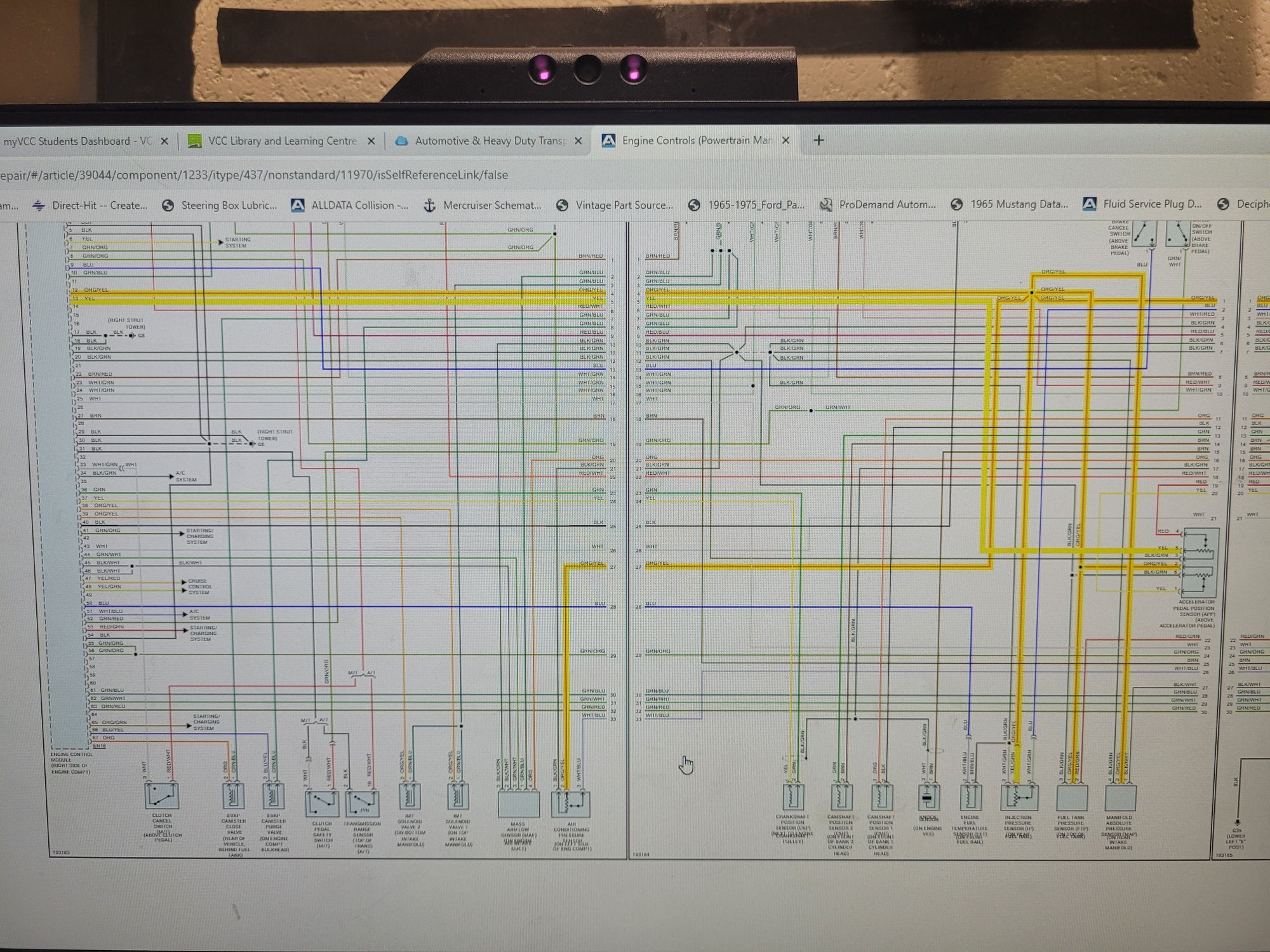

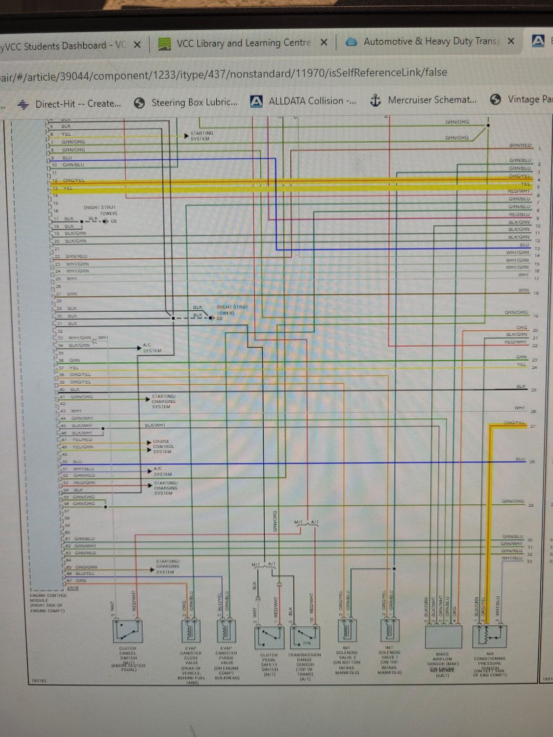

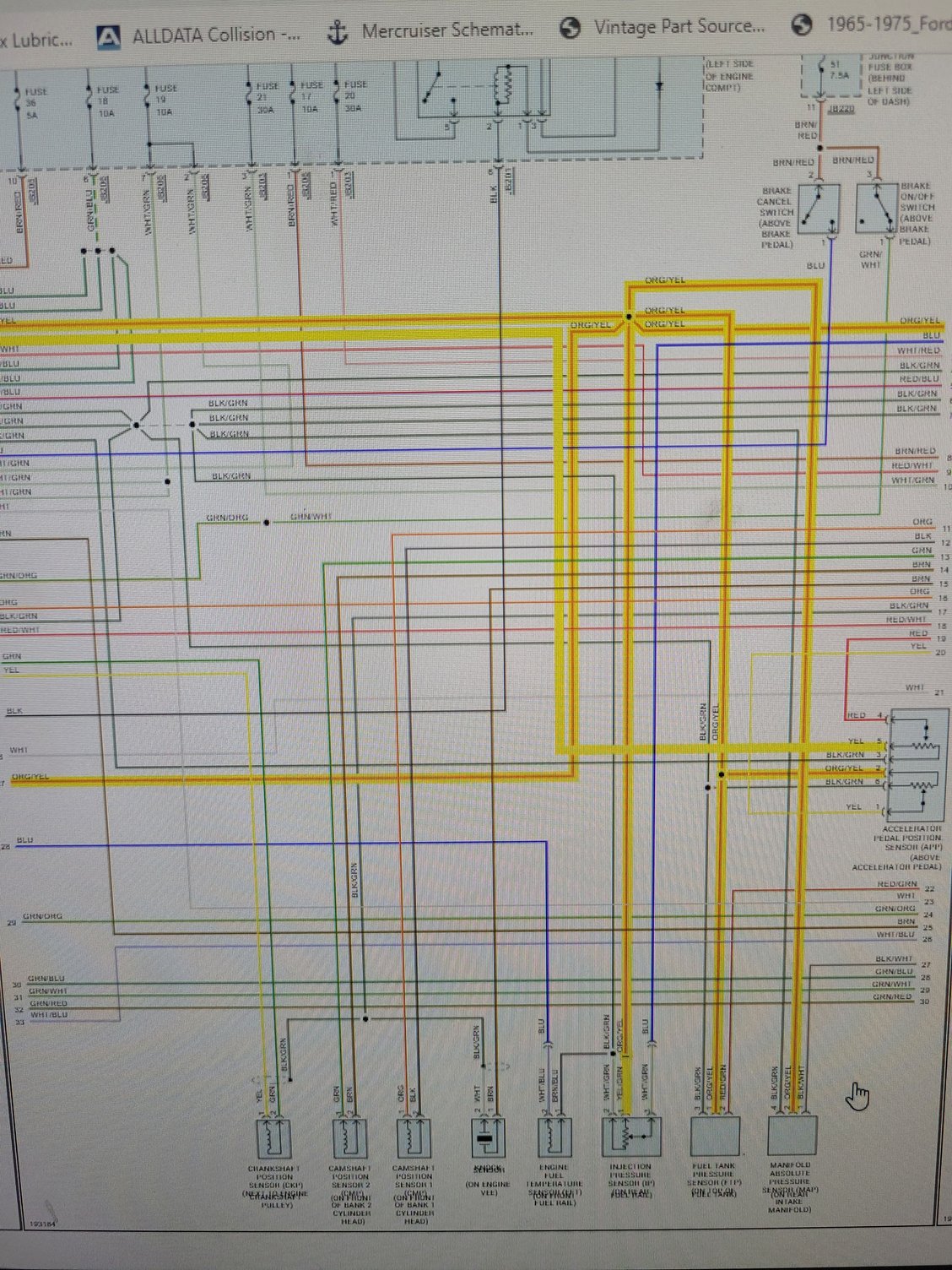

@dh53
Thank you, i can post the wiring diagram i am look at similar to the one u have sent. I know i don't have power at IP sensor. I have power at pin 2 on MAF. Right now I am in the process in taking out the fuel tank, which I think I should continue so I can check the FTP sensor as well. I will go home and take a look at the other TB and the APP sensor. Should I take out the ecm connector and check for 5v on Pin 12? But I am getting 5V (4.99) at the MAF pin 2. Ohhh wait I am a dumbass MAF and MAP is different BRUHHH. okay so I don't know if I have power at any of the connectors which I will check. Where is the MAP sensor located?
Old May 16, 2024 | 02:55 PM
  #179
dh53's Avatar
Joined: Jan 2018
Posts: 442
Likes: 64
From: Baltimore
Top of the intake manifold toward the firewall.
Old May 16, 2024 | 05:40 PM
  #180
HELP's Avatar
Joined: Apr 2023
Posts: 270
From: vancouver
https://www.youtube.com/watch?v=tT8UP1w2wg0
okay thank you
Here are the pictures of the diagram i am looking at
