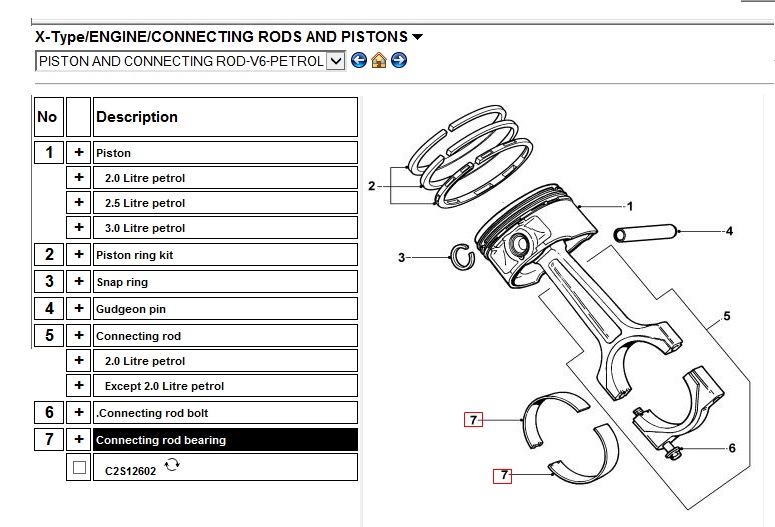

I'm assuming your main interest is in identifying the right Con Rod bearings?
As expected, the Parts Catalogue lists different Pistons (item 1) and different Con Rods (item 5) for 2.0, 2.5 and 3.0 litre X-Type engines.
However it only lists one P/N for Con Rod Bearings (item 7) suggesting they are identical across the different capacity engines.

GGG, thanks!!!
I bought bearings for 3.0, they are identical to my 2.5.
Same bearing are used for 2.5 and 3.0 Duratec Ford.
One bearing is worn out, crank is damaged, I need to repair journal and install new most likely over sized bearing.
BTW, according to your parts diagram, connecting rods for 2.5 and 3.0 are the same, 2.0 is different.
