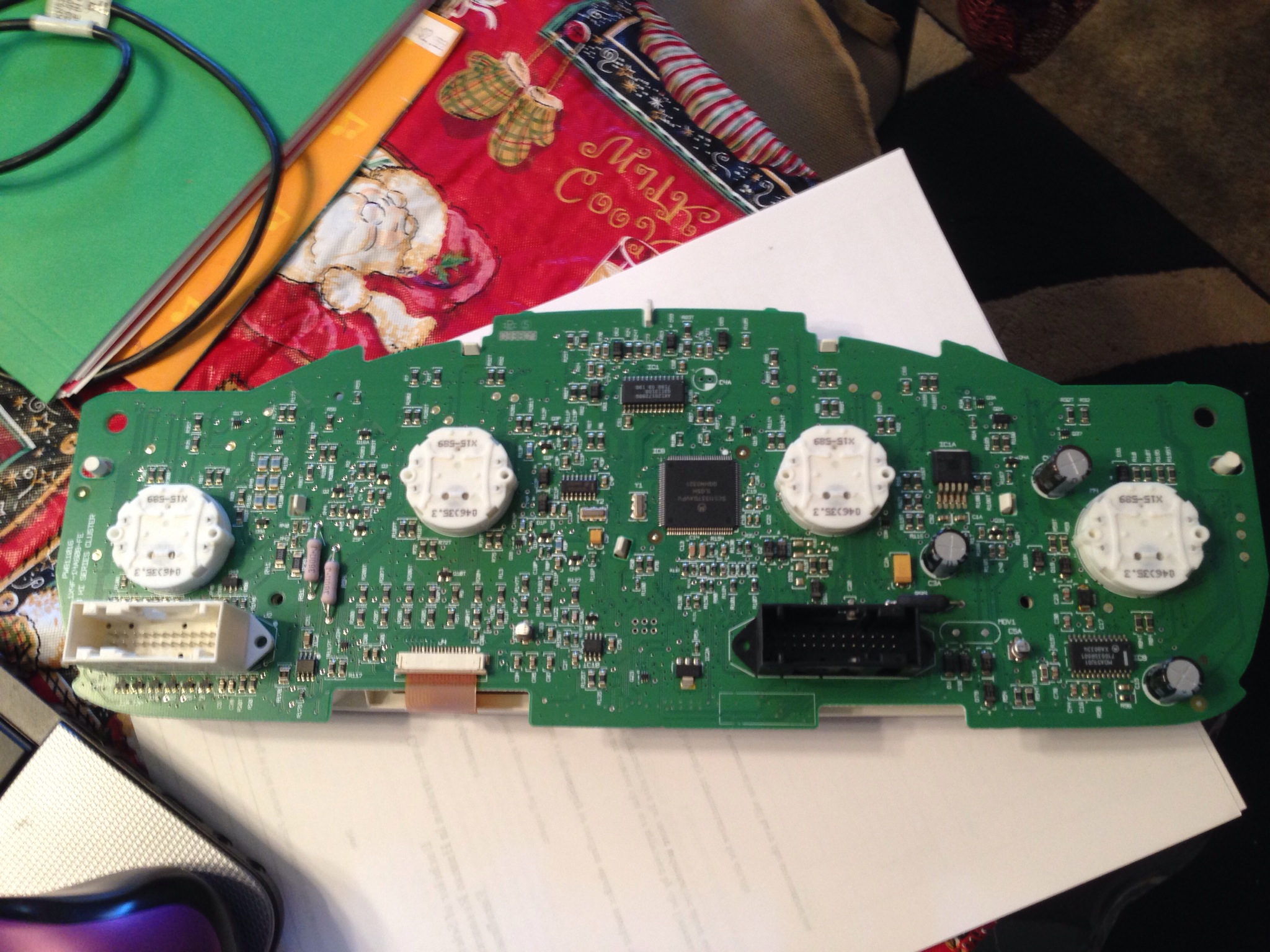

Hi, I know what you mean with it all, my dad can solder those for me if need be but the problem Im running into right now is the panel itself. Its being held together bu the 4 gauges and so I cant even look to see if there are any hairline breaks to fix. The white round parts on the back dont pull out and I can see where the gauge line goes from one side to the other but have no idea how to pull it apart from there...If at all possible, dont want to end up breaking it and having to replace the whole thing. Im sure its pricey $$$

Did you try getting it apart by those four white plastic locking tabs? Generally those sorts of things snap together. Not sure if you would loosen that and the whole gauge would come up or you would have to remove the gauge pointers first. I would guess those are just press fit in. Just a guess, I really don't know for sure. Good luck with it. Hope you can get it figured out and sorted soon.

Ward, the needles are just pressed on to a metal shaft. So, if you can get say a butter knife under the needle and then twist so you are lifting from the center (near the metal shaft), the needle will pop right off.
Now, one thing that I would recommend is that before you start popping those needles off, put the instrument cluster back into the car long enough to start up the car and note where the needles come to rest after about 20 seconds of idle time. You will need this information when you go to put the needles back on because you will want to put the needles back on in these same spots. The tach should be around 700, the ODO should be on 0, the temp gauge should be in line with the C mark. The big question is where your gas gauge is currently reading. You get that off, it can make for an interesting trip as you can think you have say a 1/4 tank of gas and run out of fuel. Might make for a bad day.

Okay, took apart the panel and someone did in fact break and remove the LED light on it (D78, but also D7 and D71 arent lighting up)... Is there a fix for that?

Ward, first off, the dealership can program the instrument cluster with only 1 key. Would they prefer two, of course because it saves you money in the end (won't have to go back to them if you need to program another key) and they make more money too in selling you the second key. Granted, I would tell you to look on e-bay and you can get the FOB and blank key for fairly cheap ($50 or so). Then you would have a second key to give them and get it programmed. You may want to have a locksmith cut the key for you so they think the new key is one that you got with the car.
Unfortunately, it is looking like you will need to spend the $200 to have the dealership program the instrument cluster for you.
When it comes to fixing the instrument cluster and getting the new pieces installed, unless you have electronics background, I would not consider this something a normal person would be able to do. With that being said, talk to a local DC Engineering place (someone that re-winds alternators and starters) and see who they may have in the shop or know. I am sure they could solder up things for around $100. The big thing that I fear is that whoever ripped the old parts off, may have damaged the board in the process which would make a repair by you tons more difficult. IT is one of those things that a tech would need to have the board in hand to get a true grasp of whether it can be repaired.

Hard to tell from the picture, but it looks like those are fairly large sized components and if you could determine what make and part number they are you might be able to buy some from a distributor and solder them in. What might be the most difficult part is being able to buy just a couple. Those sorts of things are typically sold by the reel. Maybe you could find someone that would take pity on you and they would send you a sample strip. Really sucks I know. Hope it works out for you.
