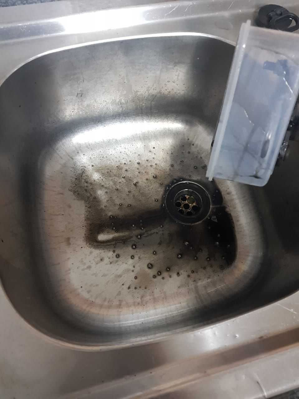

This stuff really works in loosening everything in there.
The yellow stuff is the oil (diesel).

In my case, my DPF warning light came on with a red light, also, a 'Gearbox Fault' appeared. The following day I took out my DPF and inspected it. It was rather clean. I made a contraption which I attached it to, this allowed me to rest the DPF from the 'enter' side to a pot on the stove (don't do it while your wife is at home). I inserted water into the pot, let it boil and put the DPF on top. The steam then enters and loosens all the soot. But I realised that a lot of 'oil' was coming out, A LOT. I immediately thought that it was due to the the wrong oil in my car, or over-filling. I also used heavy-duty degreaser which really helped remove particals of soot, but mostly 'oil'.
Long story short, it wasn't oil, it was DIESEL. The 2.2 X-Type strangely and in rare cases, looses the coding on its injectors? This might be due to frequently loosening battery poles or the wrong battery or a faulty battery I would suppose.
This in turn caused the injectors to fire at the incorrect intervals, the un-burned diesel then went directly to my DPF and the pressure sensor indicated 'DPF full'.
