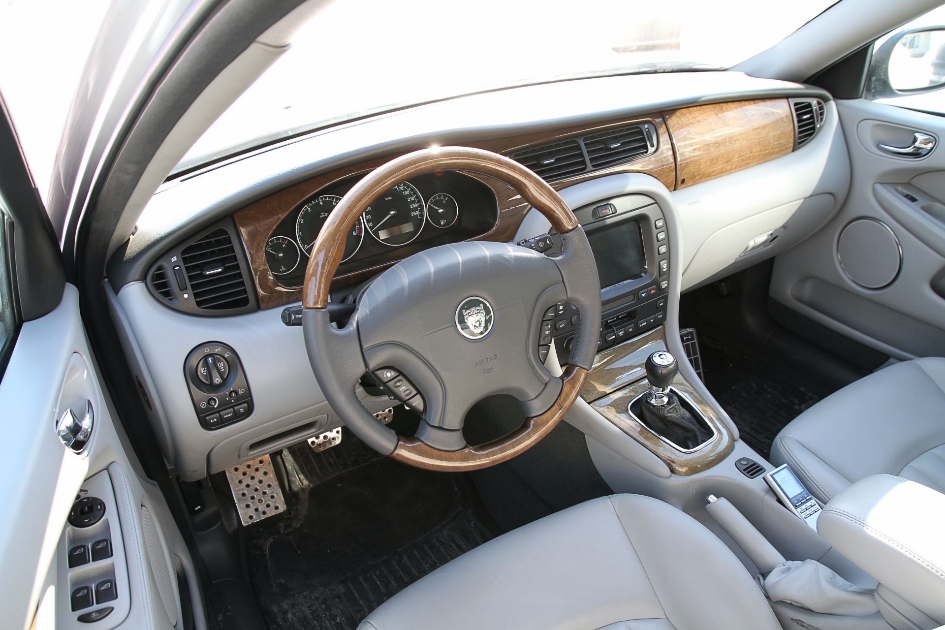

If I remember correctly, the basic one has a fairly narrow and tall display as compared to the message center -display which is very wide and not that tall. Mine looks like this, so unless your speedo-display looks different then it's probably the basic one.
