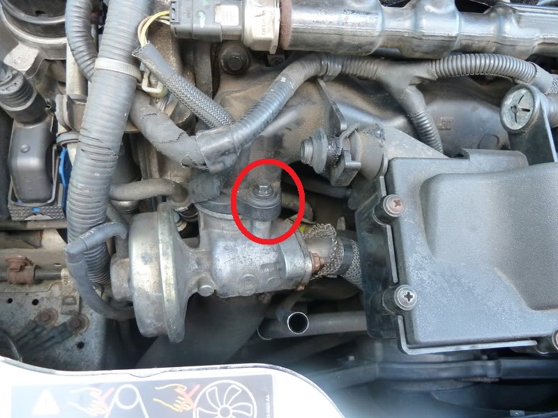

Default it was a broken screw..
Cheers Iowme
I have a diesel , couldn't get brake kleen , so went to use lighter gas..
(if I am going to die, it will be doing something i like)
When I start looking , I noticed the Nut lose on the EGR value
on further inspection, the Screw was snapped..
I am going to assume I over tightened it even thought the dealer
replaced the pipe under it only few months ago .
anyway,, Replace the nut,, Easy
Went to the dealer and they told me it it not sold on its own
but as part of the intake manifild ,, and would cost 240 Euro (about 300 dollars)
When I said that was mental, he went into ,, 'the computer says' loop
anyhow
If any one knows the Part number of the screw will
search the internet thingy
2005 2.0 turbo diesel x-type

whats that open pipe about an inch below the circle in the pic?
Old Sep 11, 2012 | 12:34 PM
Tomjones's Avatar
Joined: Aug 2012
Posts: 18
From: Ireland
Hey Iownme
That open pipe is just from the dip stick
I was putting it all back when I just snapped a pic
I don't normally leave it uncovered like that
