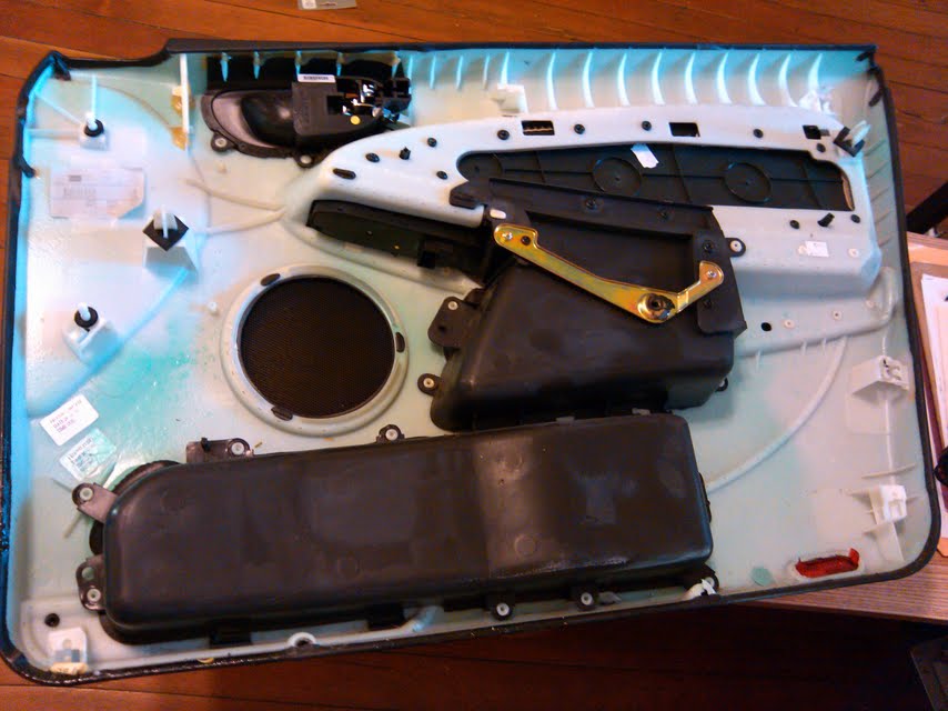

You need to remove the door panel and then remove the glue around the 3 tabs holding it in place.
Make sure to get the right tool to help remove the panel without breaking the tabs (they will break otherwise, that's for sure).

Default Jag Door Panel - driver
I happen to have my front door panels off. Here's a pic that might help you.
