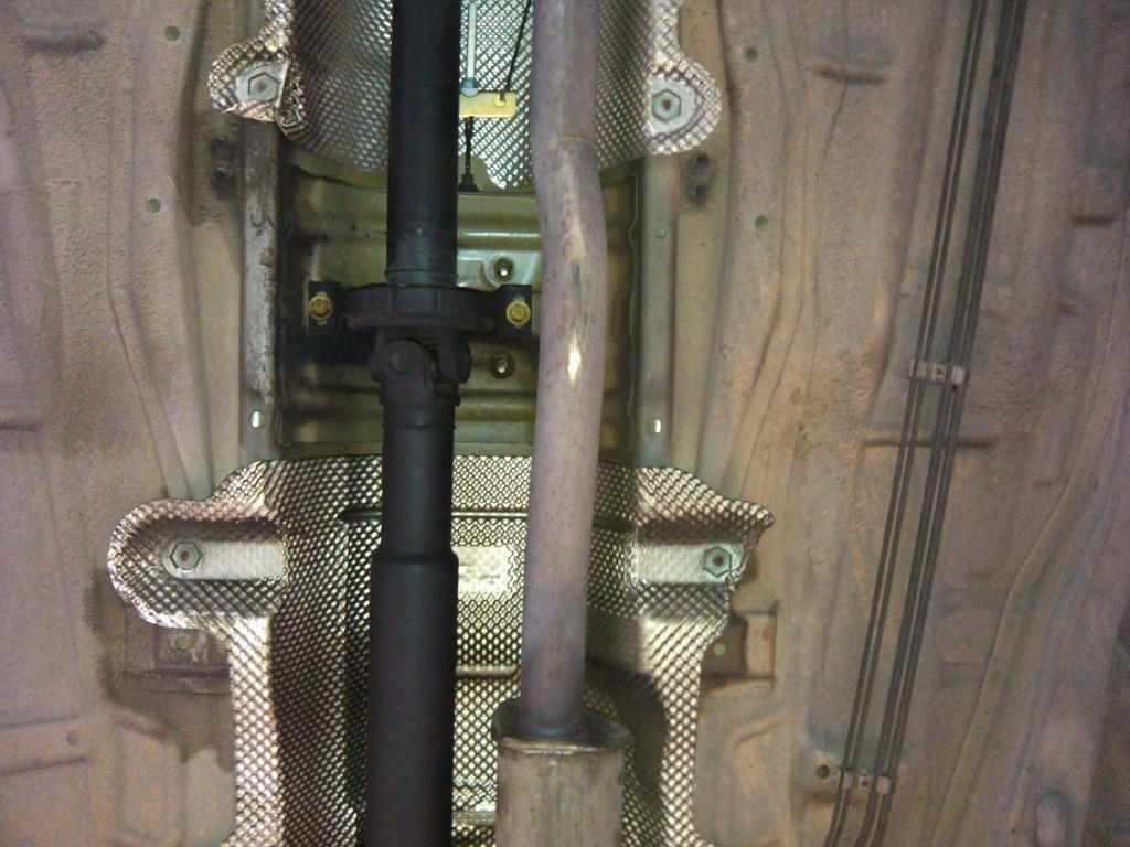

Pacobell, have you considered the main prop shaft bearing? It is just aft of the resonator, which is aft of the trans. This is a simple bearing that needs lube as the X ages. There is a thread here on greasing the center prop shaft bearing, but I can't find it at the moment. However, if you're sure your grinding noise is coming from the front side of the firewall, then this is not your problem. Your other descriptions of the noise and when it occurs indicate to me that this is a good culprit.
I've heard mine whine now and again, but I grease it up and the noise stops. If yours is grinding, I would replace it asap.
Her is a pic of the prop shaft bearing.
