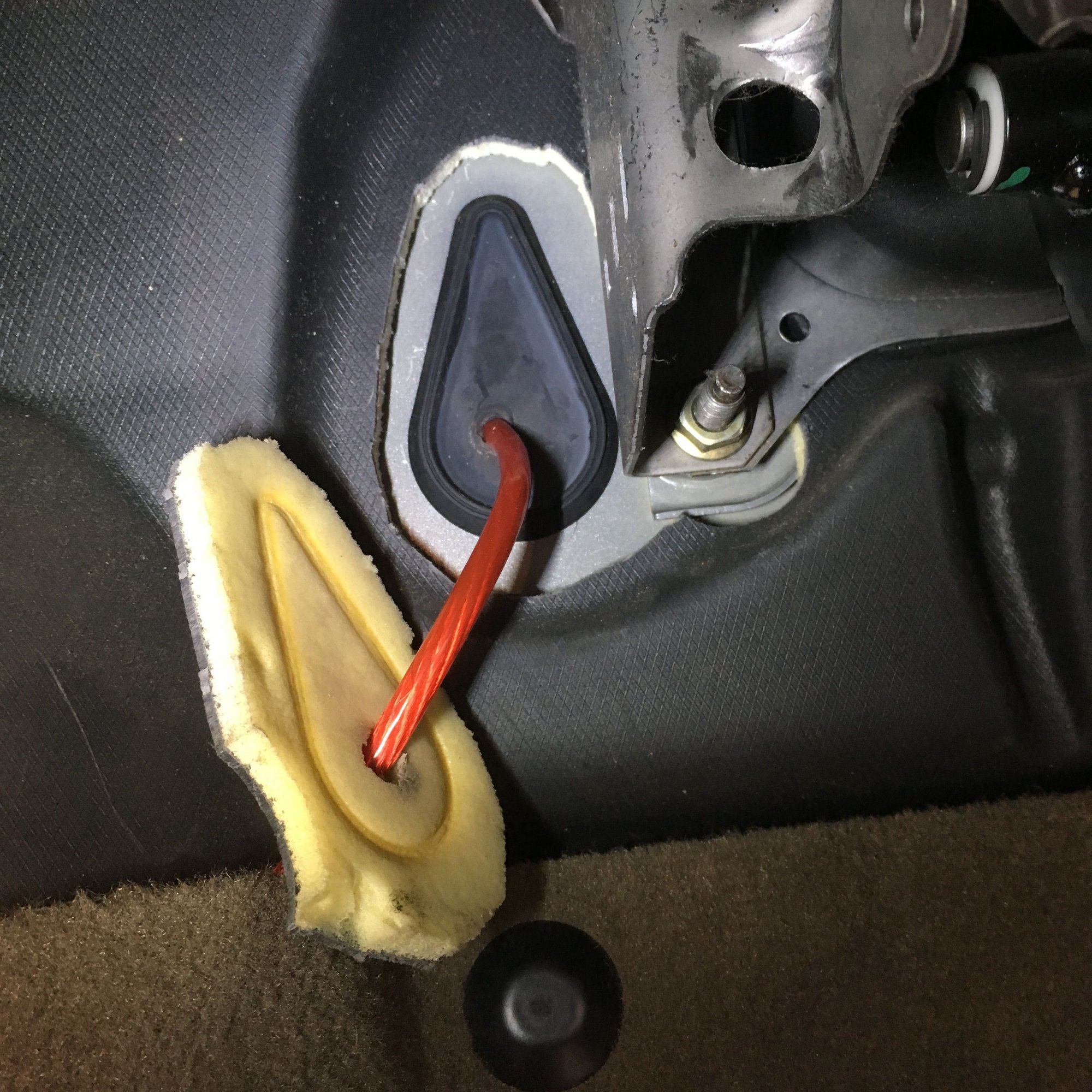

My right-hand drive car has a large teardrop shaped grommet just to the left of the steering column, very easy to access. You could easily fit several 0 guage cables through it.
To find it, look at the insulation mat just above the top edge of the carpet in the footwell, to the left of the brake pedal. There will be a perforated section which you can remove to access the 3" grommet in the firewall. Drill a hole through both and replace the cutout over the grommet for a better look and noise insulation.

So here are photos of where I found the magical "easy-wire" grommet, large enough to thread several 00 guage wire through.
This is a left-hand drive vehicle.
The rubber firewall liner is perforated for access to the grommet.
I ran the power cable around the shock tower. You should protect the wiring from heat in the engine compartment, I used high-temp split loom.

Ahh, the clutch pedal hole...didn't even think about that one! I wonder if there is one of those over on the right side, as well?
