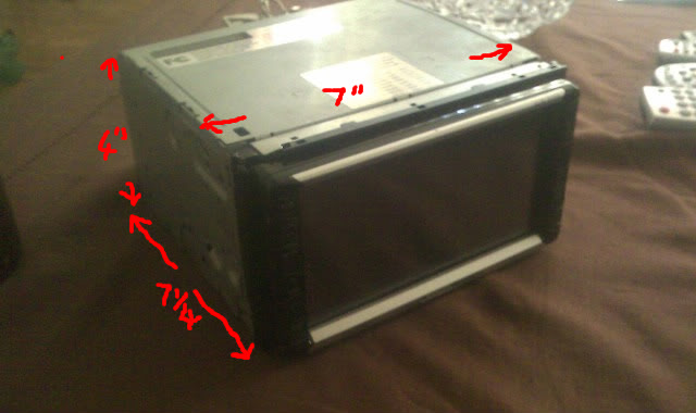

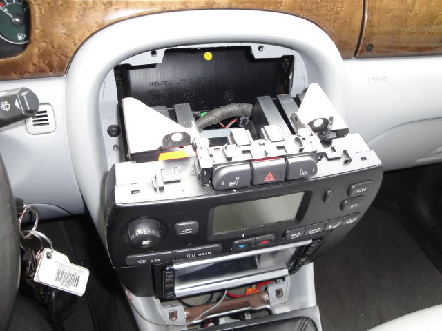

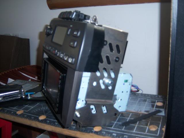

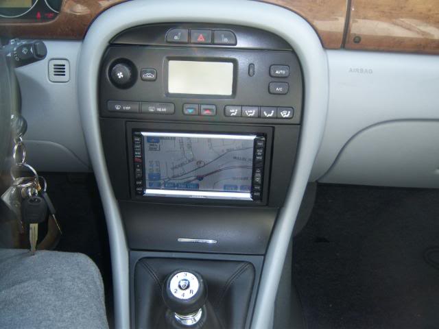

if your deck have these dimensions it will fit
pops right in
connector for steering wheel controls

here you go
