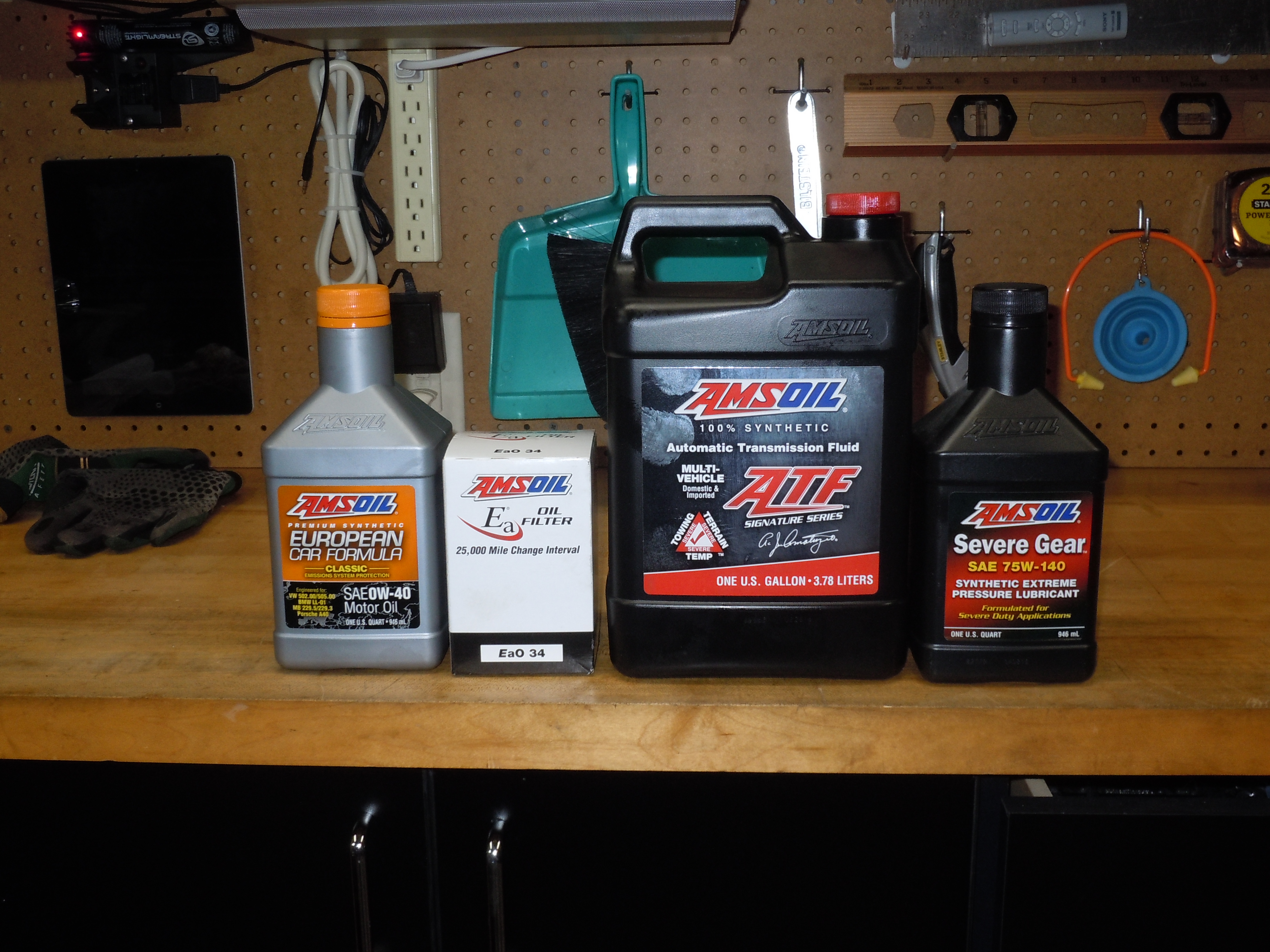

Originally Posted by Emanx2.5
Have a couple questions I hope some of you can help me with. Been getting a high pitched noise that sounds almost like a tea pot or something after starting the car and driving it in the mornings. Only get the noise after the car starts moving. Could this be the engine belts? If so which ones and how often are they supposed to be changed? I greased the proptshaft bearing this summer. Ive read of a lot of people getting that cold whine. Could that be it? I opened the hood and tried to listen but like I said only when the car is in motion is it that I hear the noise. The last things I did to the car was replace the radiator and an oil change. Any ideas?
I think your problem is little or no fluid left in the transfer case. This is a slam-dunk X-Type issue, and you'll find beaucoup threads on how to fix it. Jaguar made changing TC fluid a PITA, then covered their tracks by calling it "lifetime fluid." To me "lifetime" means "until the unit fails, then please ring us up to set an appointment for this very expensive repair." By the way, Jaguar also says ATF and diffential lube are "lifetime fluids," to which many members here say "Hogwash." Pictured are my products of choice for engine, transmission, TC and differential.
