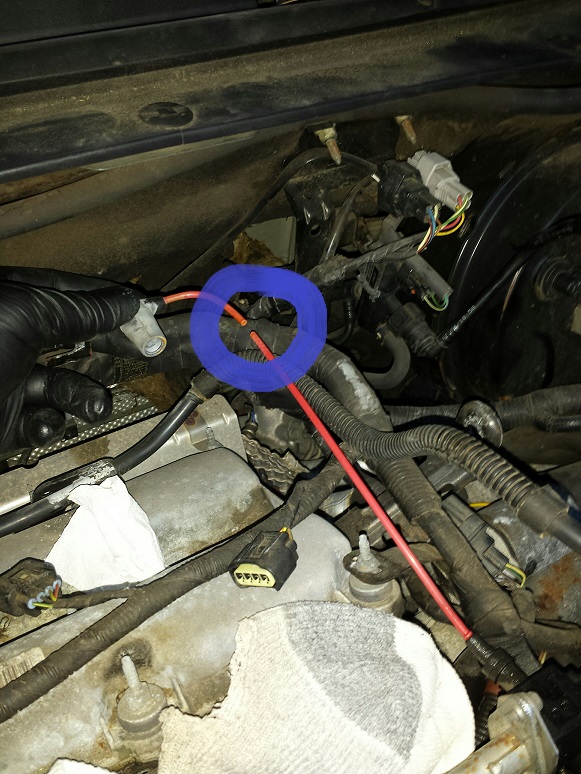

I am in the process of changing the coils on the rear bank of my X-type. Can some one tell me what the name of the hose is in the attached picture? I believe it is a vacuum hose but I cant find it on any of the parts sites.

That looks like a do it yourself fix. Where does that hose hook up to. I think I know but I want to make sure. My cell is 484-903-4813. Send me a few more pictures. I have a few here.

Dr, thanks for the reply. I have reinstalled the intake manifold but I did find these pics online. The hose I am looking to replace connects to the port they have labled as vacuum on the back of the intake manifold. The hose connects one end to this port and the other end connects to the fuel rail. See the hose circled in the second pic.

I believe the hose you are looking for is Vacuum Hose C2S28870 1each. it is called the induction vacuum hose. The part number may have been updated but it is the one in my electronic parts catalog.

You are correct, I did a quick internet search and the image looks the same. Thanks for the info.

Sure. My bad on that line. All mine are black not red. That's an easy fix. Let me know what you need. Pulling parts this weekend.

Mine has disintegrated too, did you make one or buy a genuine part?

It has been a while but I think I found a used one to replace it. At the time I was looking for the part another forum member did provide this part information. I hope it helps you also.
"Vacuum Hose C2S28870 1each. it is called the induction vacuum hose. The part number may have been updated but it is the one in my electronic parts catalog."
