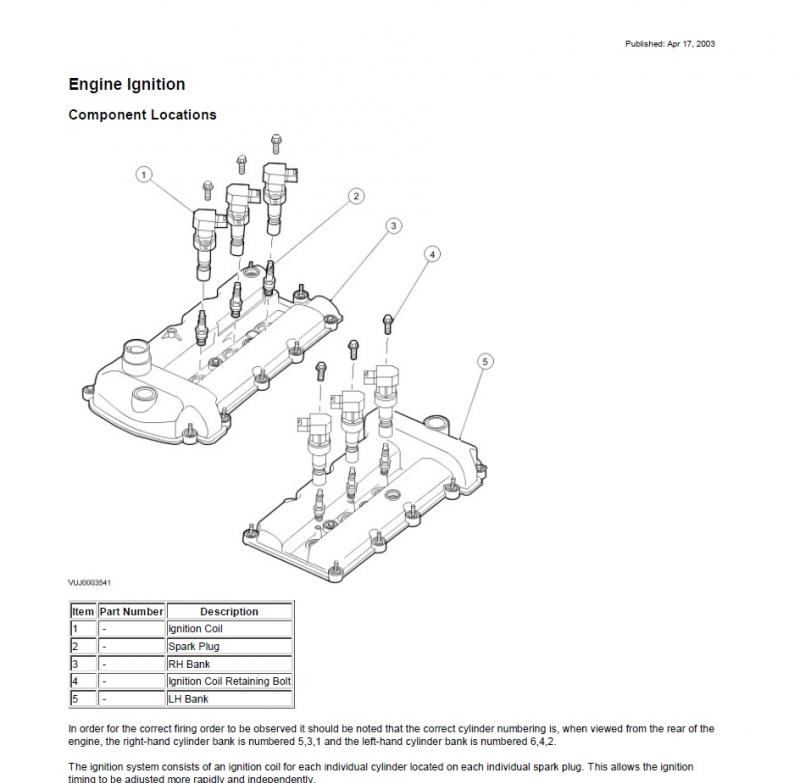

Is cylinder 2 on the front of then engine radiator side ?
If so i can swap the coils round fairly quickly to eliminate a bad coil on cylinder 2 ?

i have this from a cd i brought from ebay but still not sure if its usa or uk model any one shed any light ?
thanks tommy

which cylinder is no.2 ?
front of engine or rear ?
So you think the fact i ran the fuel tank dry has nothing to do with the problem i have ?
Would running the fuel tank dry damage a coil ?
as soon as i know which is cylinder 2 i will change it

Bank 2 is closest to the radiator right next to the oil filler (so front left coil). I had a similar situation and received P0302. What I did to confirm the issue with the coil was to switch it with bank 4 (to the right of bank 2). Cleared the codes then re-tested and received P0304 which confirmed that it was the coil. I would recommend trying this first. Mine went out for no apparent reason.
Here's the thread.
https://www.jaguarforums.com/forum/x...30-mph-105560/

Hi again managed to swap the coil and plug from cylinder ''2'' to cylinder ''4''.
Have taken the car for a good drive and now the misfire as moved to cylinder ''4''
