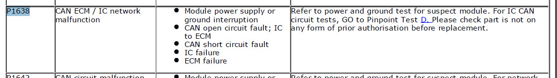

Hope this helps.
Decided to attach the the section from the manual that should shed some light.
Attached Thumbnails Help P1638 and B2141 down for a week now-b2141.jpg   Help P1638 and B2141 down for a week now-p1638.jpg   Help P1638 and B2141 down for a week now-p1638_1.jpg

Thanks for the document Paul.. This document definitely helped.We have checked the whole wiring system and found out the problem was that the power supply to the ECM was not functioning at all... Our only challenge now is finding the cable that supplies power to the ECM... I hope anyone can help me with some info on this if at all there is... Thanks guys
