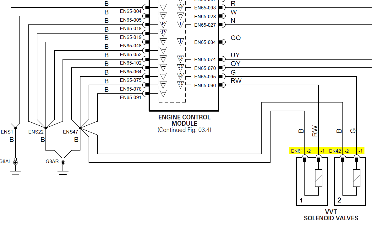

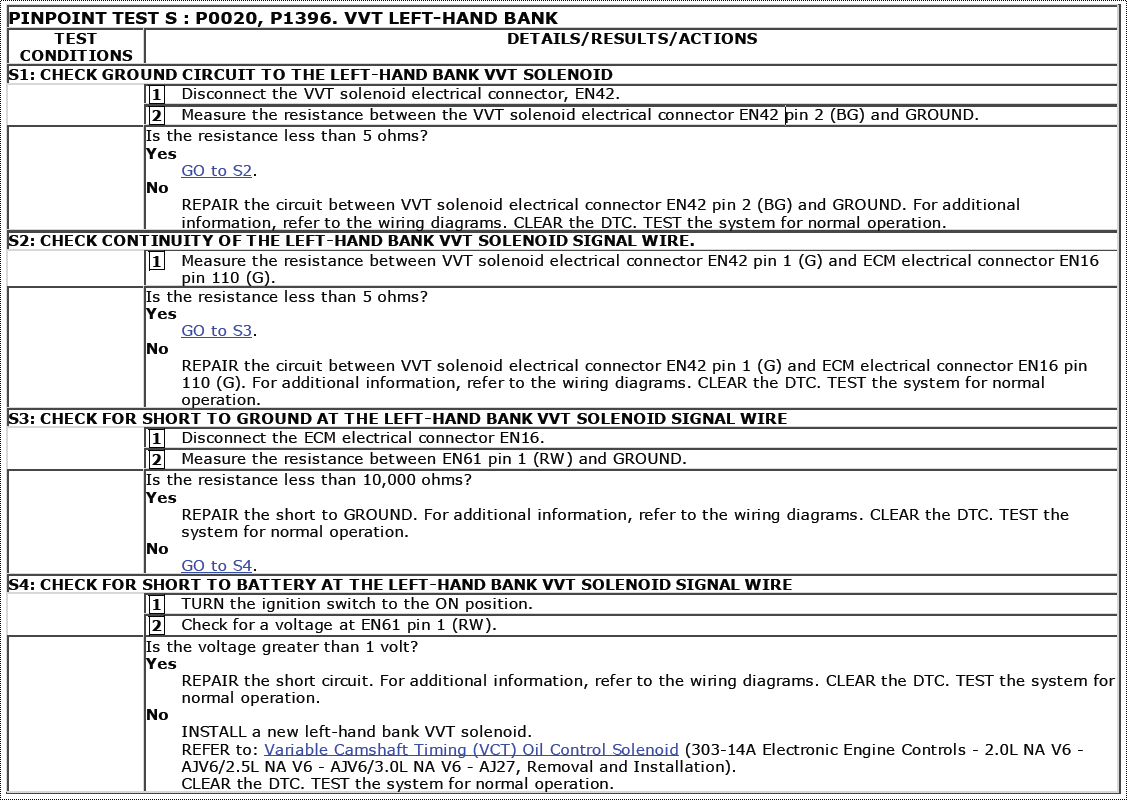

I have no experience with this code but, this is from the workshop manual page 1306.
I've searched the document but can find no references to the various connectors EN42 or EN61. Perhaps someone else might know.
Good luck.
Edit: - I found this in the wiring diagram
Attached Thumbnails How do I remove the sensor on the cam covers of a 02 X Type?-p1396.png   How do I remove the sensor on the cam covers of a 02 X Type?-p1396_1.png

Just found out that the solenoid electrical connector the green wire which is for the ground was not functional so I cut into it and ground it into another location now it reads when I use meter it shows that it's grounded- but code still appears p1396
