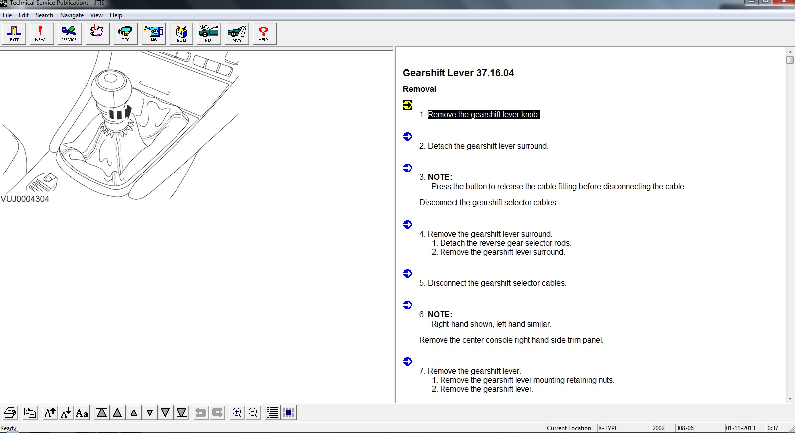

Is there some trick to removing an 02 X-Type Shift Knob on the Manual Transmission? I just got a new knob (but it seems wrong - Shift Knob, Manual trans, Leather [Part#: C2S13208]), but in any case I need to replace my worn knob and shift boot (that is also on order).
Before I start this process I want to be sure there is no gotcha here that will leave me without a working shifter and wanting for some special tool I don't have. I would think it just screws off but ive seen other threads indicating its more complex than that.

Welcome to the forum Homey,
It appears to simply unscrew anticlockwise:
How to remove / replace 02 X-Type Shift Knob-shift.jpg

Thanks GGG, ill give it a try
Homey
