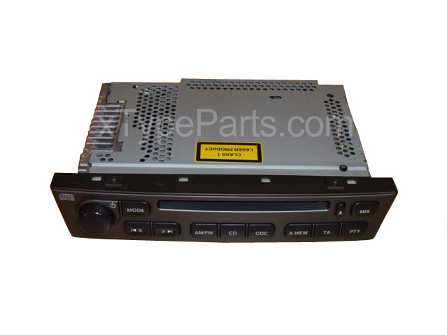

No, I'm talking about the CD player that goes under the radio; it replaced the tape deck in later models (see photo).
As for the GPS antenne, yes that was included.
Mark
