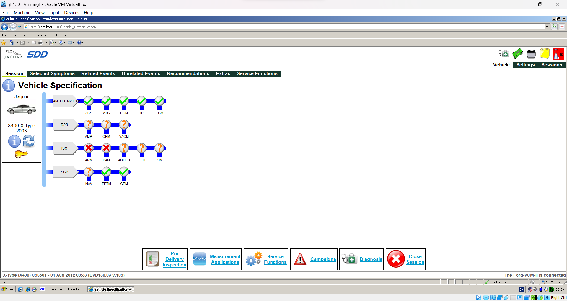

Hi folks, been absent for a bit nonetheless. I wanted to chime in for @Gophat and go over my setup, which was borne out of all the info on this site.
1 - Oracle Virtual Box - My current laptop is a 64-bit running windows 11
2 - SDD v130 virtual machine image available by a google drive download
3 - Full chip VCM2 diagnostic scanner ( Ford Rotunda )
I don't know why the majority say it won't work. I've successfully reprogrammed ECM without issue and am able to run all the test on SDD. It turns out that the seller I purchased from manufactured the same piece for a known Ford-approved vendor. I know this because I'm a developer working on developing open-source vehicle diagnostic and communicated with the seller regarding drivers for their machine, which they could not provide for said reasons—nonetheless, the seller-provided IDS v101, which I never used.
Through endless hours of researching for drivers, I came across the Ford VCM ver 1.9, which I copied over to my virtual machine and installed so SDD could communicate with it. Fact is, here is my latest screenshot from my most recent scan.
The lower right-hand corner shows that VCM 2 is connected.
I hope this helps, @Gophat. If you'd like more details, you can shoot me a message.
