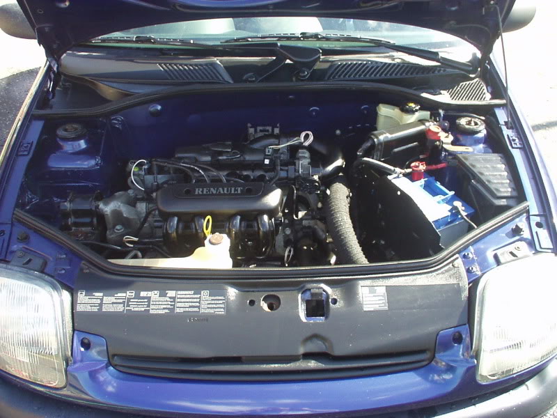

Below is a before and after shot of my sons Renault Clio, a little 1.2 ten year old car.

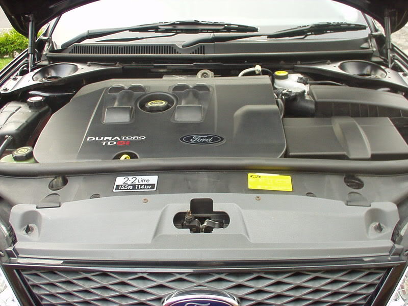

Below Ford Mondeo ST Tdci

I know they're not Jags, but even so the same principle applies.
Don't use a pressure washer or you're asking for trouble.
Intially I'd use a spray bottle to dampen under the hood and in the general engine bay area. Have a good APC ( All purpose Cleaner ) to hand and perhaps a degreaser.
A 2" paintbrush is useful for when you've sprayed the cleaner, using the paintbrush to agitate in the tight and difficult to reach areas.
A good wash down on the underside of the boonet / hood area too is always a good idea.
You can if you're worried use a plastic bag to wrap around any delicate areas and use an elastic band to secure.
Once all washed down, give it a good drying off with a clean rag and then perhaps using some wet n black / trye dressing type product to blacken any hoses and plastics, then run the maybe take for a decent drive getting up to temp to aid the dying process, removing any plastic bags you may have used earlier.
