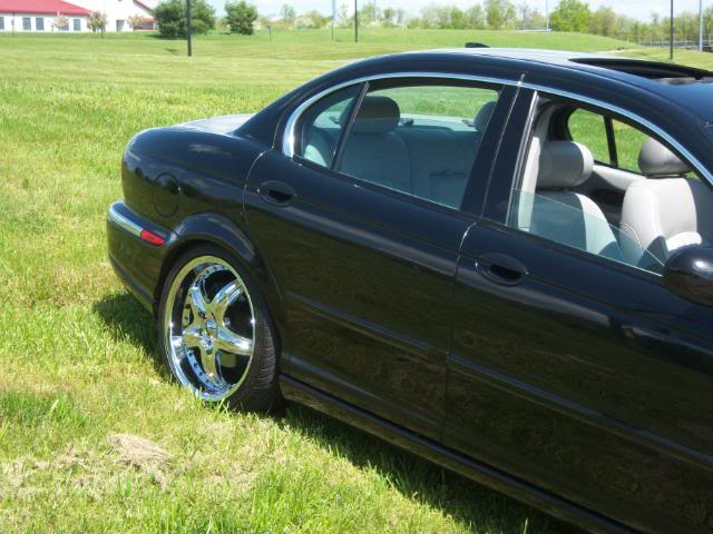

Ive recently put my new wheels on my X type, I bought Eibach lowerings springs but i think it might be too low and rub. I just wanted another opinion on what I should do Name:  jagp1.jpg

I doubt it will rub with Eibach springs - they engineer them to not go as low in order to avoid rubbing. Your wheels look pretty high offset and you probably have 225/40/18s on there, which is a factory size. You're fine.
I've lowered mine a little on 18s, too. I don't rub with 9.5" wide wheels.
Edit: note: your car will sit quite a bit higher on Eibachs.

it wont rub at all
very comertable ride

When I put Eibachs on my sport, I still got about an inch drop front and rear. Rear was on top of 225/40/18 and front had about 3/4" tire-to-fender gap.

This is were my H&R springs ended up
These are 20" wheels with the same overall diameter as OEM 18s. You can see the rear fender is on top of the tire and there is about a 1/2" gap in front. So it should lower you about 1.5" based on your photo above.
