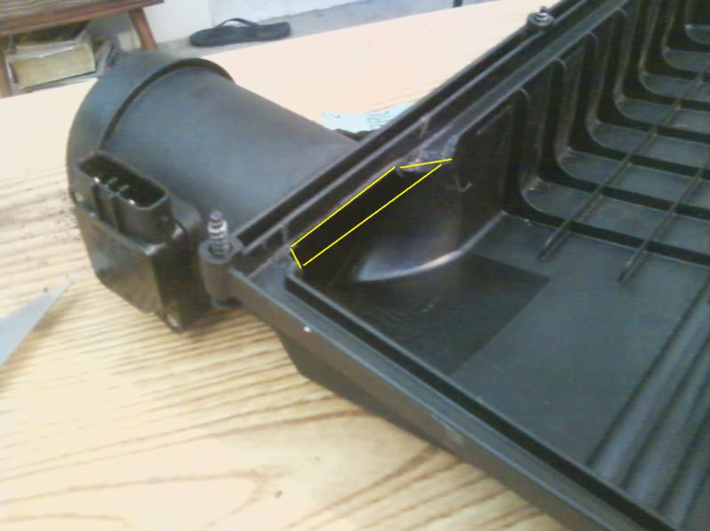

I did numbers 1 & 3, and I definitely notice more pull when I accelerate. Especially since it has cooled down in AZ lately, the air is nice and cool. This pic shows where I removed part of the plastic rim that blocks some air flow.
