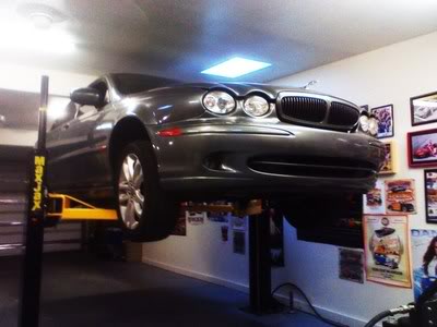

Iownme, I see, so there is no need to support the motor/trans assembly while you remove and replace the lower motor mount?
I will buy the 2 motor mounts next month and let you know how it goes replacing them. I actually do have access to a lift, I just have to keep in good graces with my gf's grandfather. Not trying to show off, but here is my car on the Lift in his garage. The undercarriage is about 5 ft off the ground.
