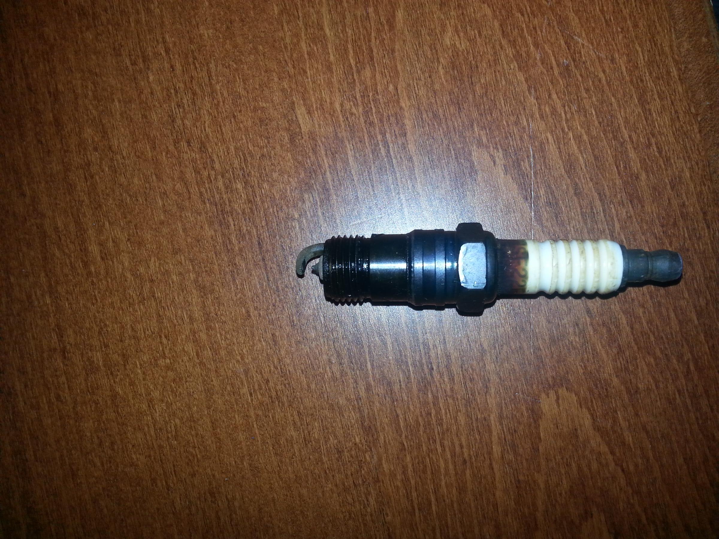

Yagurete, I would first start with access the plug for the #2 cylinder and seeing if you have a little bit of oil around the coil. It is possible that a little bit of oil has built up around the plug and it is now grounding out, not allowing the cylinder to fire properly. I recently had the same issue and that is what mine turned out to be. I pulled the coil, removed the spark plug (found lots of oil on the end of the plug), cleaned the plug up, reinstalled everything and it has been good ever since.
You may want to check the top of the coil just to make sure that it is not cracking and what you are experiencing is a failing coil. If you want more info, let me know.

I just finished checking the coil and spark plug. Well theres a lot of oil on the plug but the coil doesn't appear to have any cracking.
I cleaned the plug up and tested
I'm now getting only P0302 and P1314.
My next step is to switch the coil out with the one from cylinder 4 and see if the code moves.
Reading this post it looks like it could be the coil (as you suggested Thermo), plug or fuel injector.
I'm planing on changing all the plugs soon (now maybe sooner)
It looks like there is a lot of oil on the plug, so does that mean my valve cover gasket is shot? If so how difficult is that to change haven't seen any guides on this.
