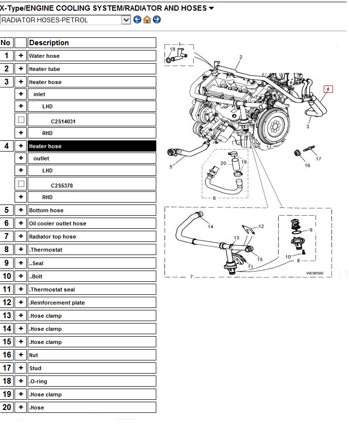

Old Jun 25, 2013 | 09:17 AM
Originally Posted by afonda
Is the "return hose" also the "outlet hose"?
URO Parts C2S5378 Heater Hose Outlet : Amazon.com : Automotive
Found this on Rock Auto and Amazon.com...
Thanks,
Andy
Item 3 (Inlet) and Item 4 (Outlet) have different Part Numbers in the Jaguar EPC:
Click on the image to enlarge it.

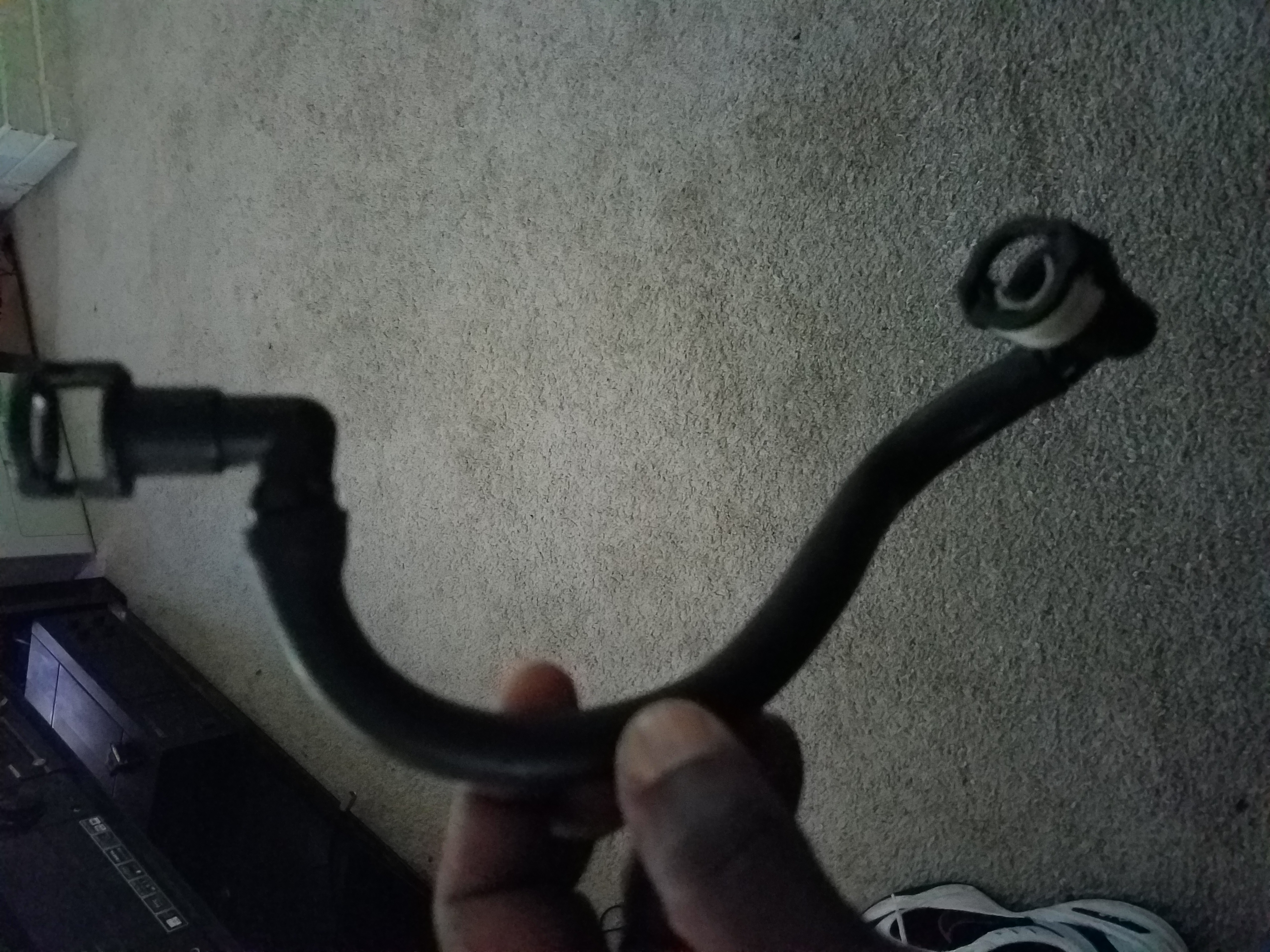

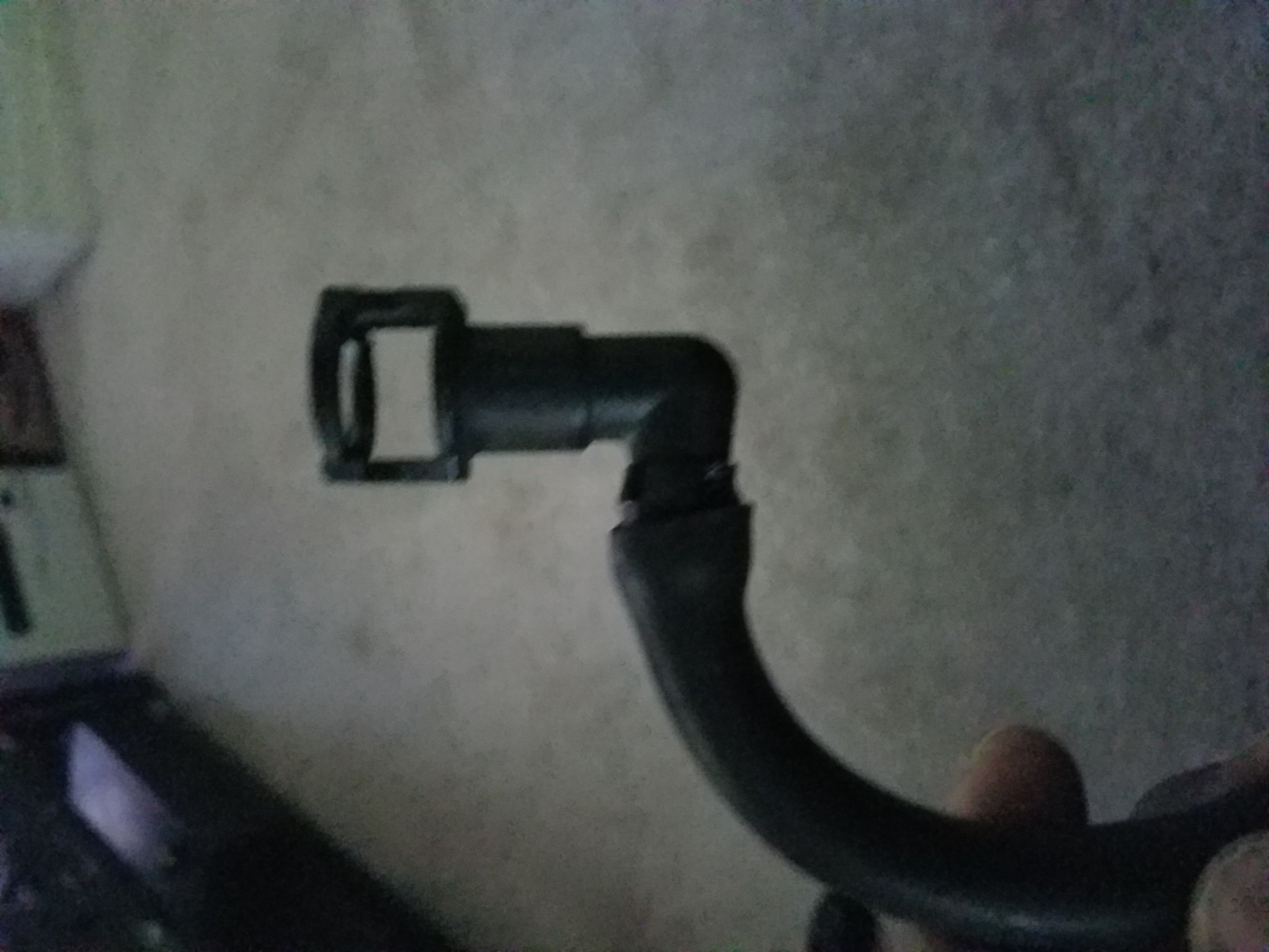

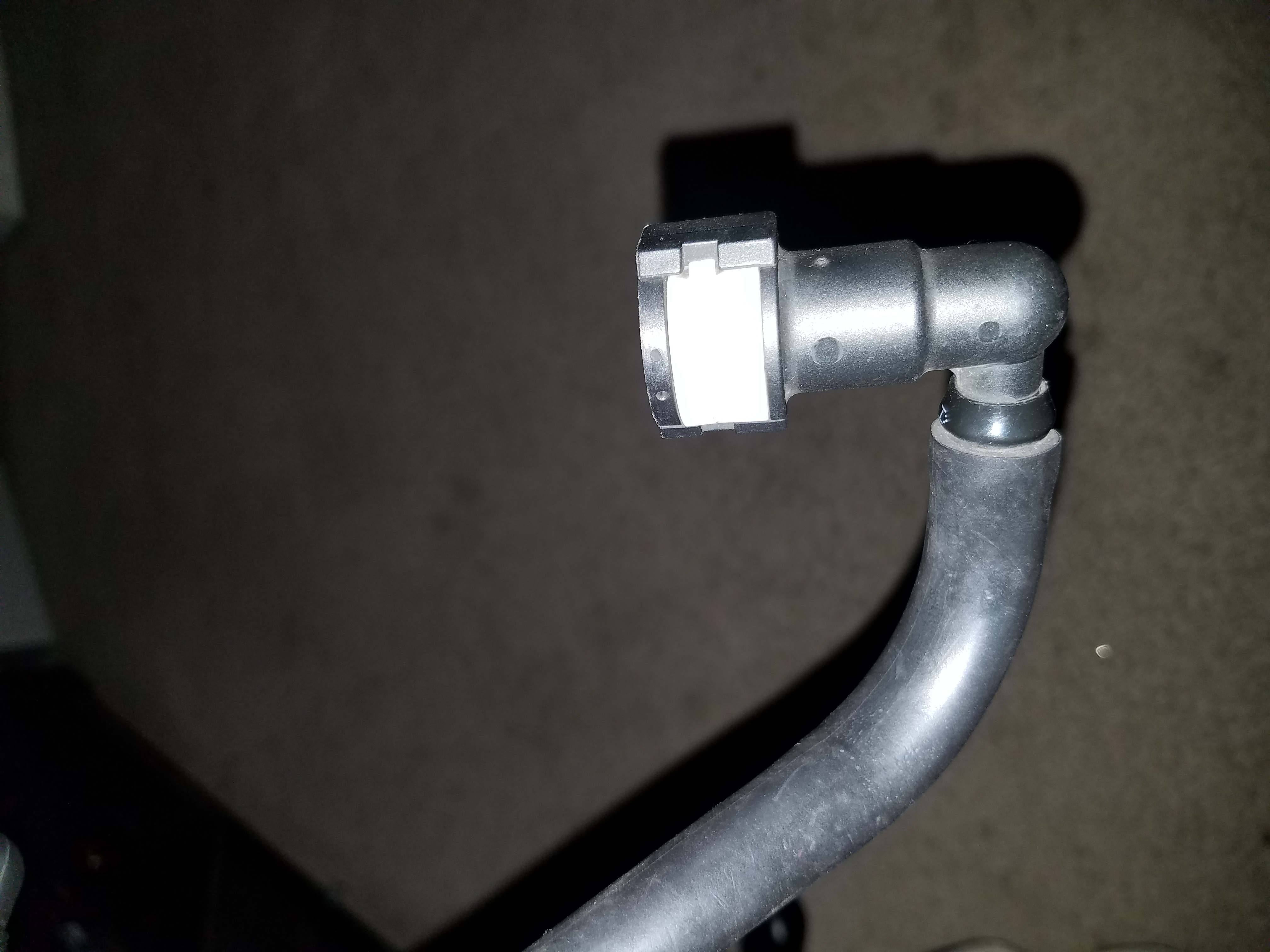

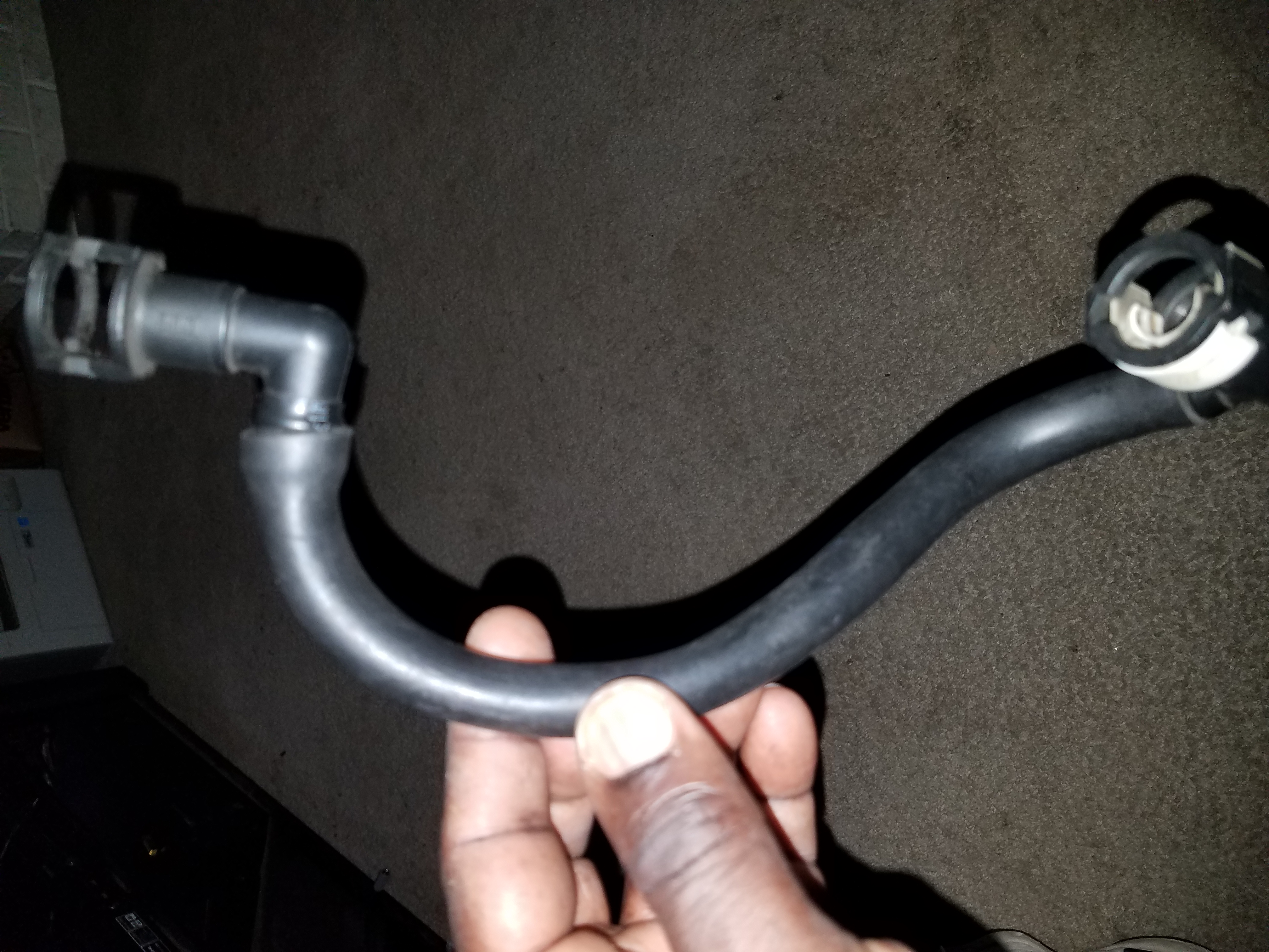

Old Jun 9, 2017 | 09:46 AM
mbald417's Avatar
Joined: Jun 2017
Posts: 1
From: decatur alabama
Default can someone tell me what is this part
been looking for this part dealer can't find it with out a number
Attached Thumbnails Name this hose-20170609_092940.jpg   Name this hose-20170609_092944.jpg   Name this hose-20170609_092946.jpg   Name this hose-20170609_092954.jpg
