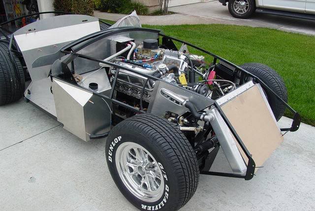

Not bragging but I built this in my garage.

OMG! That is STUNNING

Stickman, don't tease me with a car like that. I am waiting patiently for a house so I can have a garage to work on a vehicle like that. I am torn between either a 1970 Dodge Charger (with a blown Viper V10), a 1923 T-Bucket, or a 1933 Vicky. We'll see. So many toys, so little space and money.

Stickman, lovely Cobra. I went with Akebono euro pads for really low dust and the Centric rotors from Tirerack. Price was decent and didn't think I needed drilled/slotted rotors as I'm a fairly tame driver myself.
