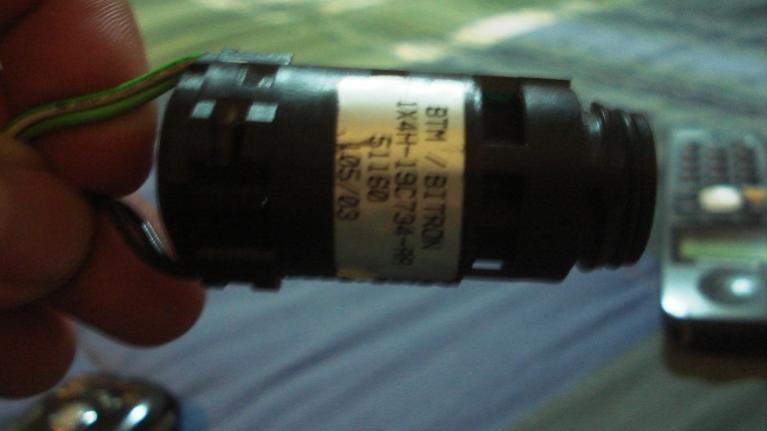

Hello everyone, I have a 2003 X-Type 3.0 AWD with automatic transmission.
I recently removed the Center console and Instrument Panel and found a part *1X4H-19C734-AA* that is connected to the wiring Harness, but looks like should fit somewhere, but don't know where or what is for.
I'm posting 3 pictures of the Item
Appreciate any help you can give me.

That part is your aspirator/in car temp sensor. Its part of you automatic climate control- it sucks air in through the little 1''X1'' vent to the right of your steering column. You could test to see if a new one has been installed and the one you found was left behind by cranking your car, turning on the air on auto, and putting a small torn off peice of paper the size of the vent in front of it. If it holds the piece of paper to the vent, all is well.

Thanks for the info I went inside and there was no new part. So I reconnected it. Everything working fine.
