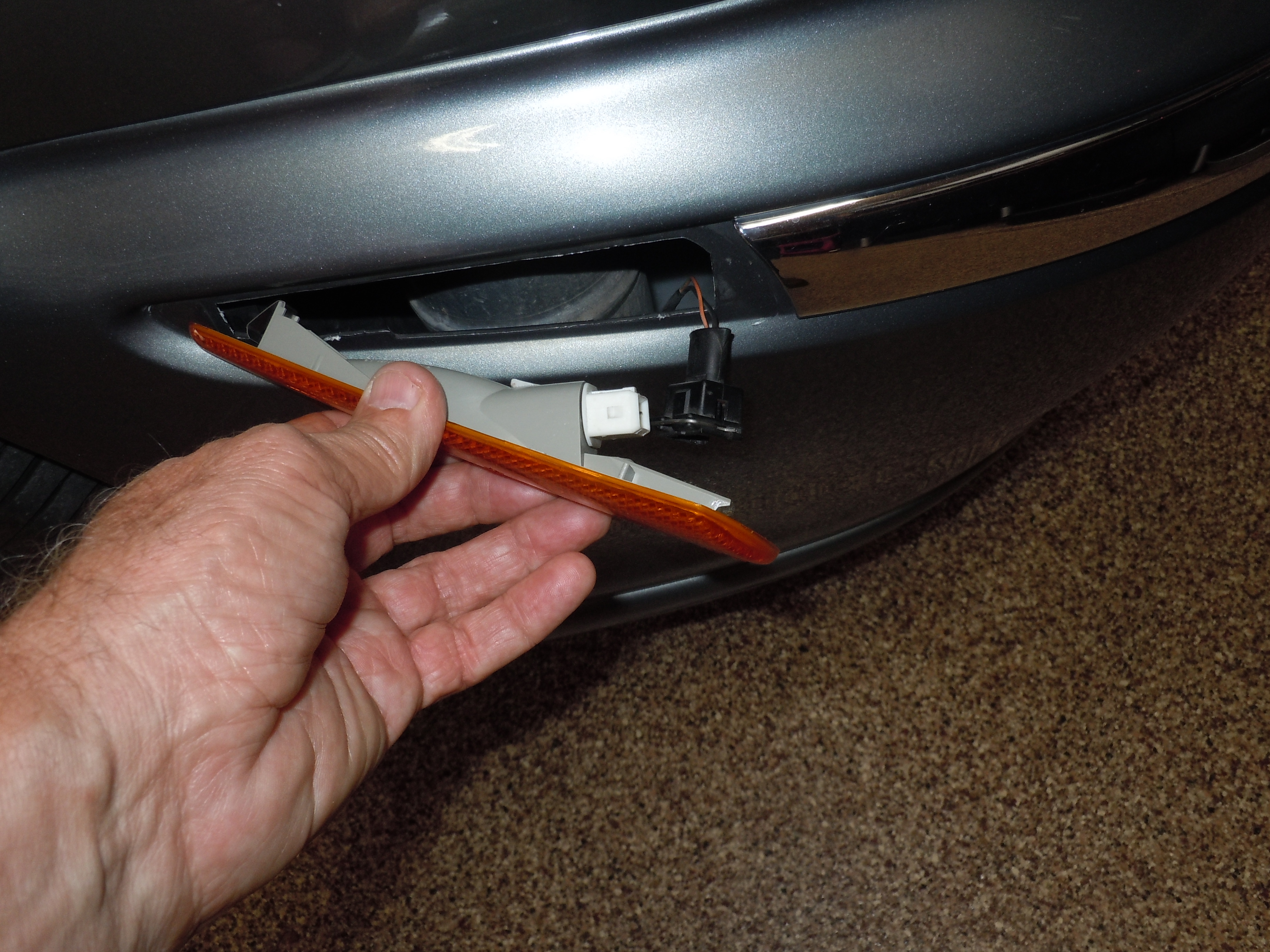

The side marker lights are spring-loaded forward. To remove them get a plastic trim tool and push light to rear, then rotate forward edge out when groove clears fender edge. Picture is of right front side marker light. You'll see the spring clip at rear of the housing. Hope this helps.

Yeah, the rear ones pop right out, but the front ones are a bugger. The black plug is just a LITTLE bit larger than the opening in the fender. Quite a job to get it through the hole without bending the metal or having it pop off in spite of the holding clip and falling into the fender (did that once, fished it back up with a coat hanger).
