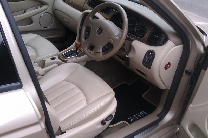

Hi All , just bought a 3.0 auto with sport button , sat/nav .power mirrors etc , 77k and in lovely order , it has no issues apart from the rear parking sensors not working (getting 4 sec beep but are all ticking) and a slight whine at 40 mph but its four wheel drive and as its very slight i have no concerns , loving the car and am looking forward to many miles of jaguar ownership and am hooked!

Welcome! Steering wheel's on the wrong side but other than that looks good. I really like the colour.

X-Type looks great. Can't believe you found sunshine in Blairgowrie this year to take the pics!
