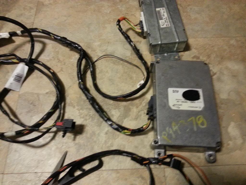

this is the phone and voice module ,

Dennis,
Not sure I understand your reply. I do not have a touch-screen. Where would I look to see if I have the modules you've shown in the pictures. I looked in the boot area (believe that's the trunk) and did not see any panels on the side I could look in. I think I did see the 'Sig' message come up at one point, which I believe would indicate that the phone module is installed, but now all I get is the message 'No Phone'. Any help would be appreciated. I really can't afford to take it to the dealer right now.
