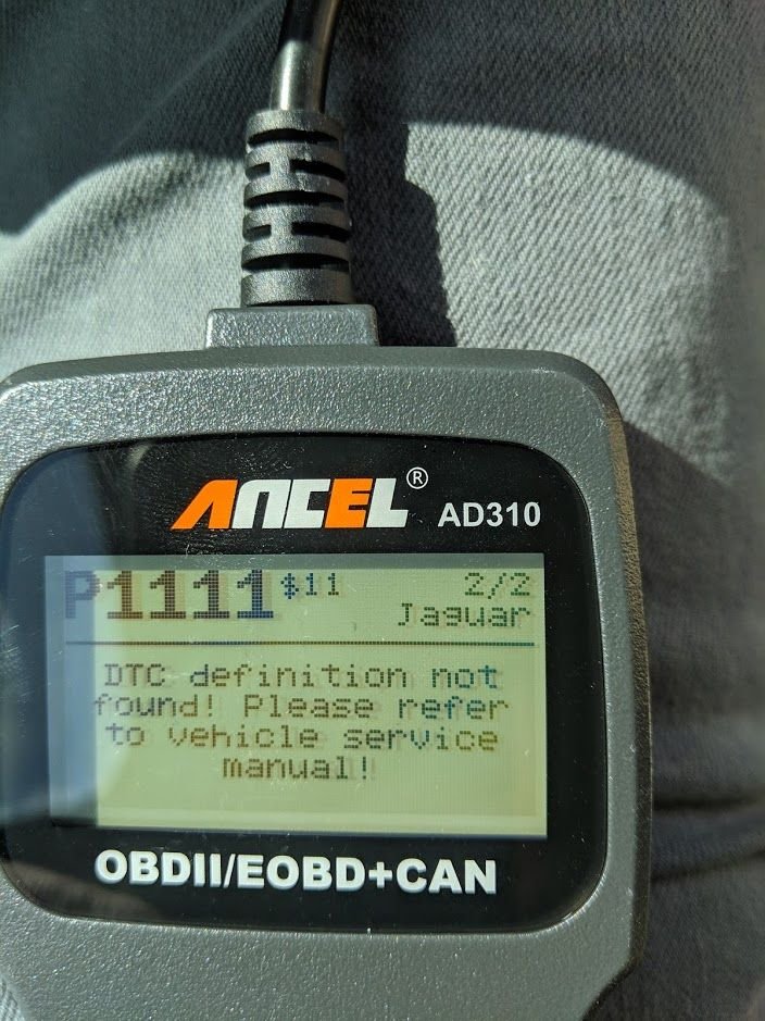

I have a P0193 code plus amber engine light, prior to this I was starting to see occasional hesitation on acceleration.
Research seems to indicate the most likely cause to be faulty Fuel Rail Pressure Sensor although it could be electrical related, I decided I would first try changing it out before taking on electrical diagnostics.
Here are the codes I got:
