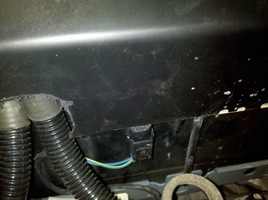

Thermo, thanks so much for the informative reply. After work today, the drivetrain light came back on along with the CEL. Later in the drive, it actually started shifting harder. Once I finally got home and popped the hood I found right behind the battery cover this blue and green connector DISCONNECTED completely.
I saw that it would fit right in to the battery cover and plugged it in - perfect fit. A couple months ago, I had some work done to replace the battery and all the connectors. I wonder if the tech didn't properly connect it?
Anyways, i started the car and the CEL was still there. Drove it down the street and CEL/Drivetrain light went away and it began shifting like normal again.
Thanks for your help Thermo!

I hate to tell u but that wire doesn't do anything anymore...its for a part installed at assembly and removed before the car is sold.
When it comes to transmissions wirth this car you should have a good tranny specialest check it out....a replacement @ jag dealer I was quoted 8grand or so...rebuild was a little above 4grand....
What is your car doing when you are in drive, car running abd fully stopped? Anything seem different at all?
