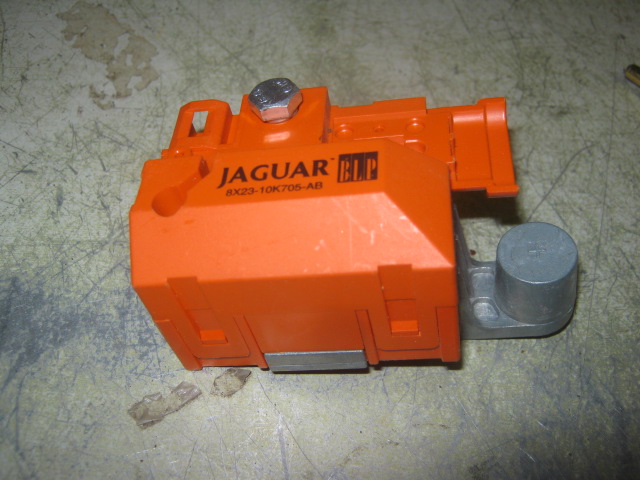

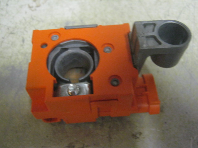

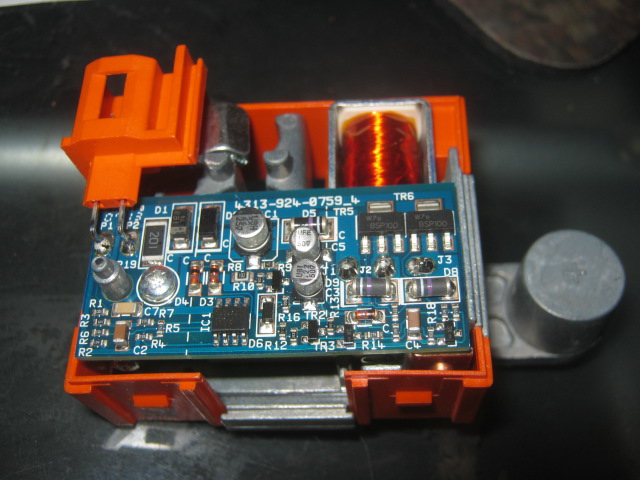

Old post, but this is what the battery isolators look like that come from Jaguar....
I ended up with a box of them after purchasing a lot of inventory from a dealer..
David
EverydayXJ.com
