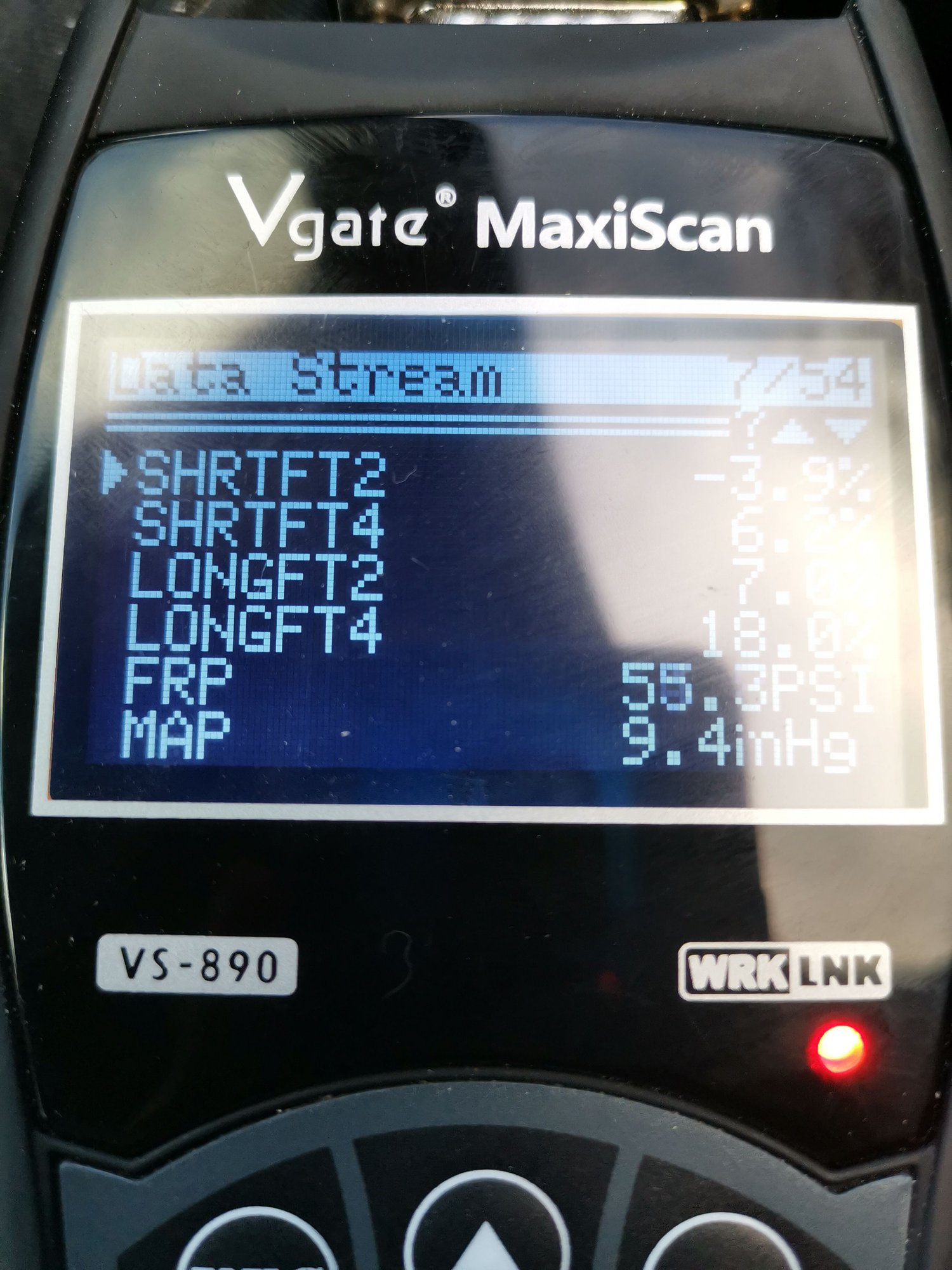

​​​​​​I got off the throttle and let it idle now that short trims were unstuck and saw the short trims slowly drop from high negatives along with long trims dropping from high positives to the point of fluctuating quite well. That's when I took the picture you see uploaded.

The pic is mainly reflection but those readings are a mess.
Could be almost anything, from bad cat(s) to dirty MAF to ... anything.
If you're sure your tool properly supports the kinds of O2 sensors the car uses then at least one bad cat would be #1 suspect. Don't bother with additives in that case. You can have a try to diagnose via looking (borescope), IR temperature, listen or whatever.
