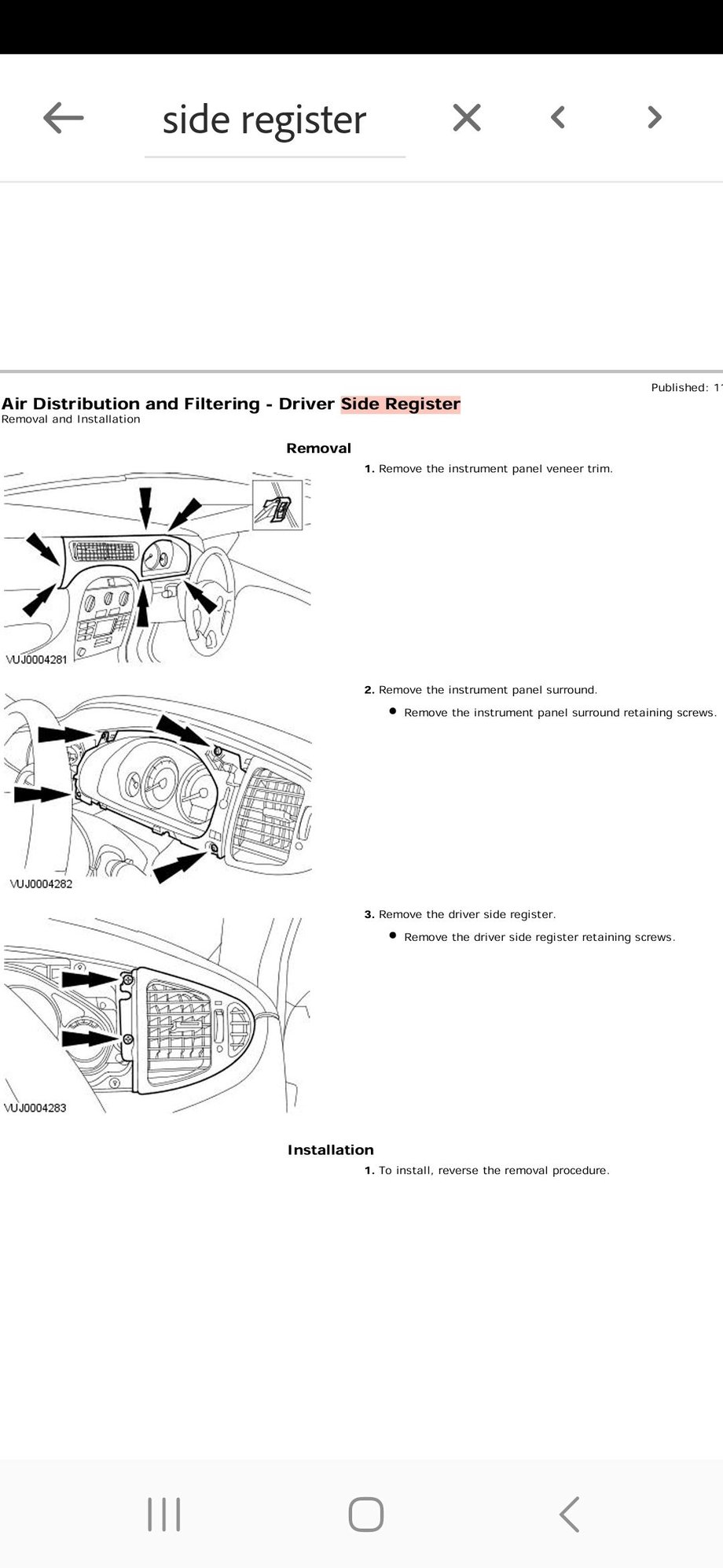

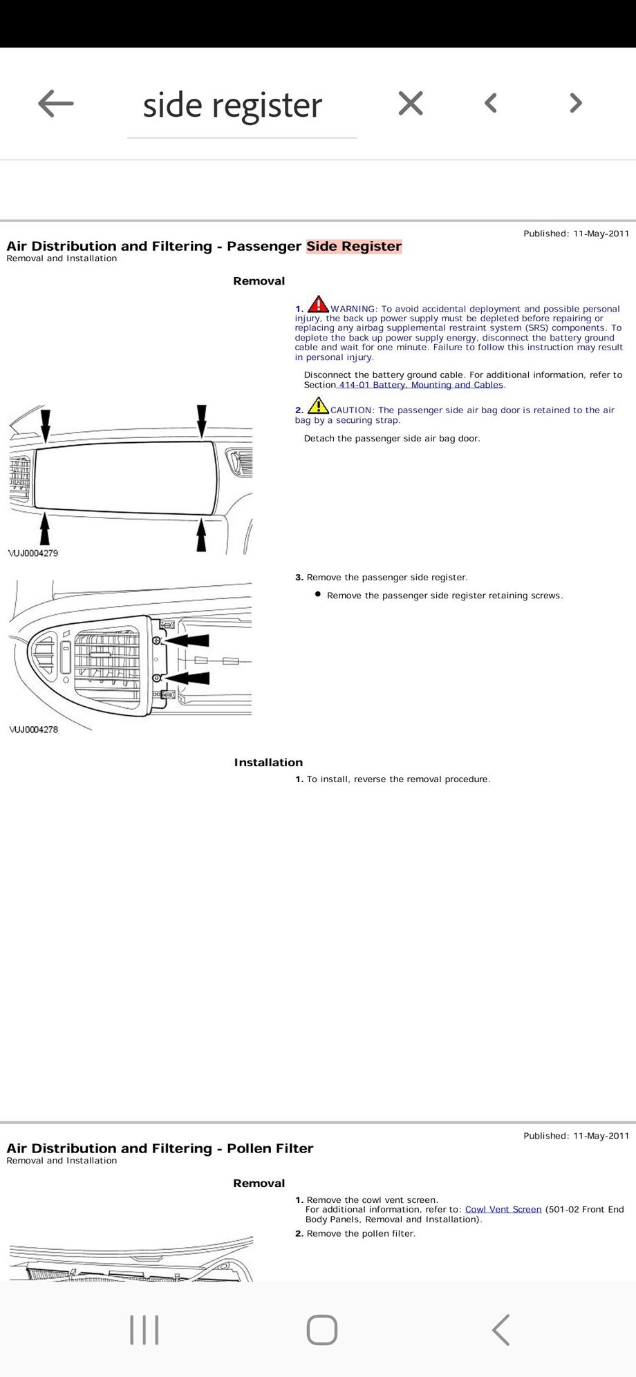

The procedure is in the workshop manual
BTW, if searching they are called side registers not vents. Vents bring up the defroster dash vents.

Dell, thanks for information. In the manual it only addresses removing the door (after disconnecting the negative battery terminal), at the four points. It doesn’t address whether a special tool is required to pop the door off like a panel removal tool. Can you advise? TIA

I've never done it, but it should "pop/snap" out just like the center console does.
