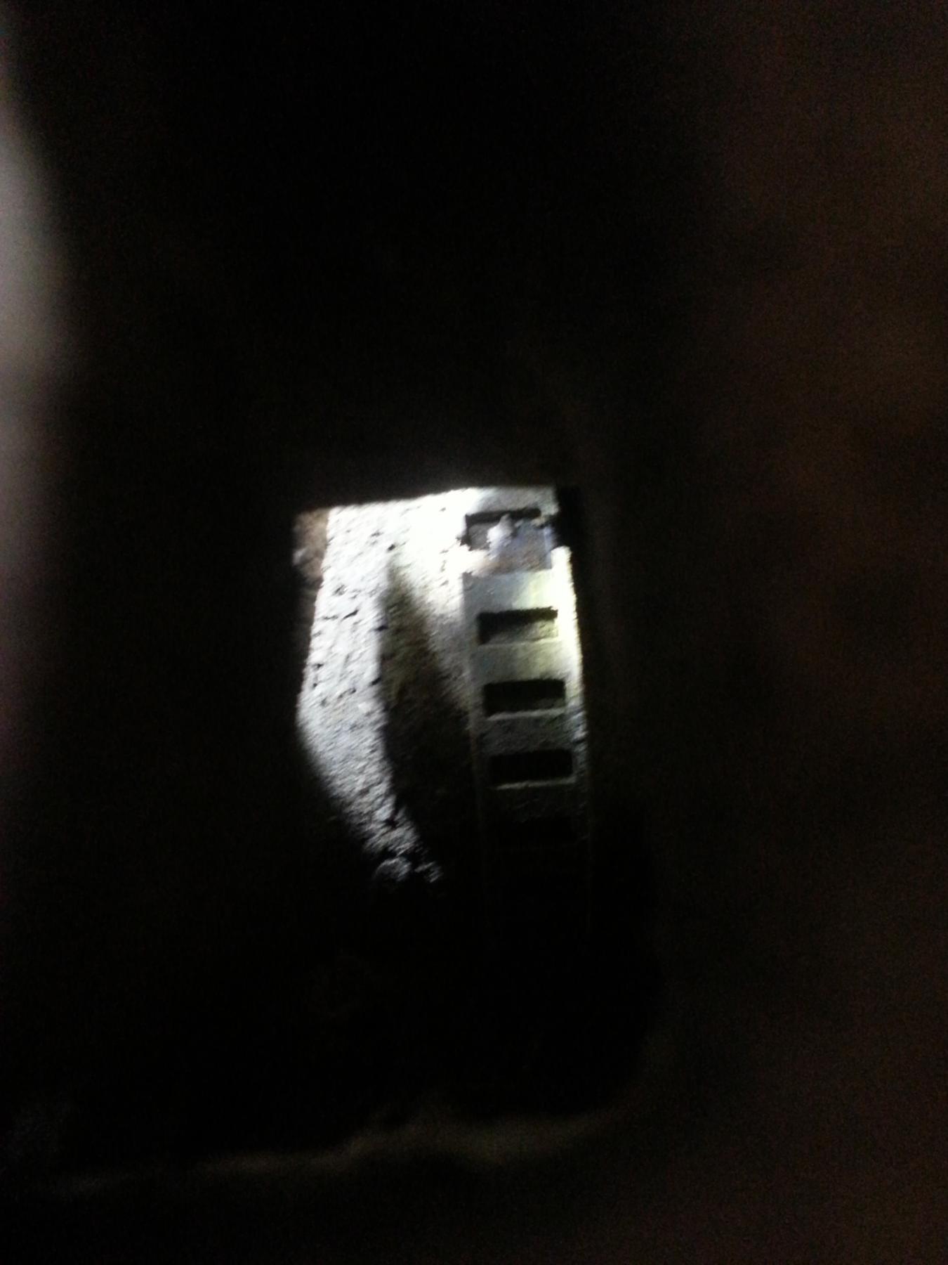

HI i had the very same problem , abs + mil light on and no speedo also codes were c1165 and c1175 .. turned out both rings on the outer rear cv joints were corroded and snapped Quick Question About ABS Sensor & Check Engine Light...-2014-05-26-11.43.45.jpg
