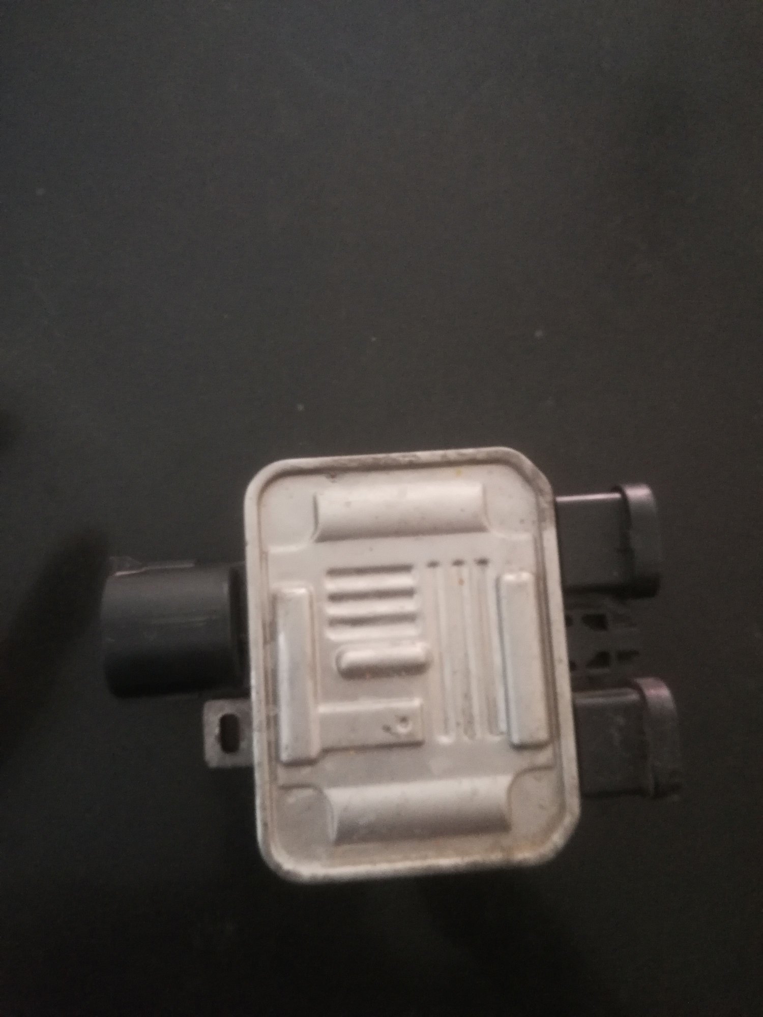

I have done just that, removed the blue and white wire, tapped it, reconnected the fan cable nd battery, it immediately ran. So thus confirms the module is damaged.
I will have to get a new one after lock down. Thanks a lot, you a indeed the best sir. In the meantime i will open and have a look at the module internally. If i had the expertise i would fix the transistors and reconnect.

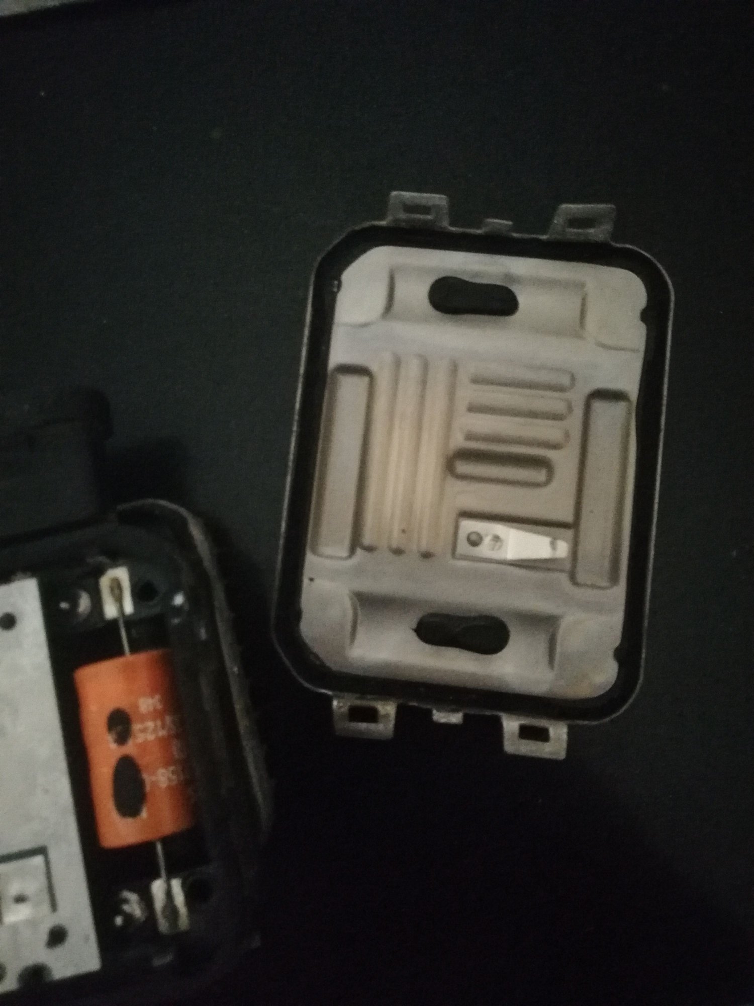

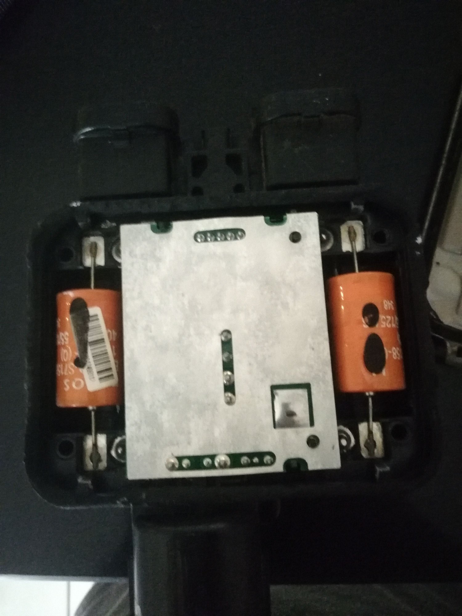

Everything looks mint, not burnt areas. The paste is not that much.

Keleb, see that dark green board hidden under the silver plate, that is where you need to look. That is where the transistors are. You may find that they will show signs of heat damage. But, odds are, it will be in your best interest just to get a new module (do not buy the cheapo chinese ones, spend the extra to get a real controller. The factory fans are current mongers. They each pull something like 40-50 amps. That is really hard on the electronics. hence why the controllers fail a lot.

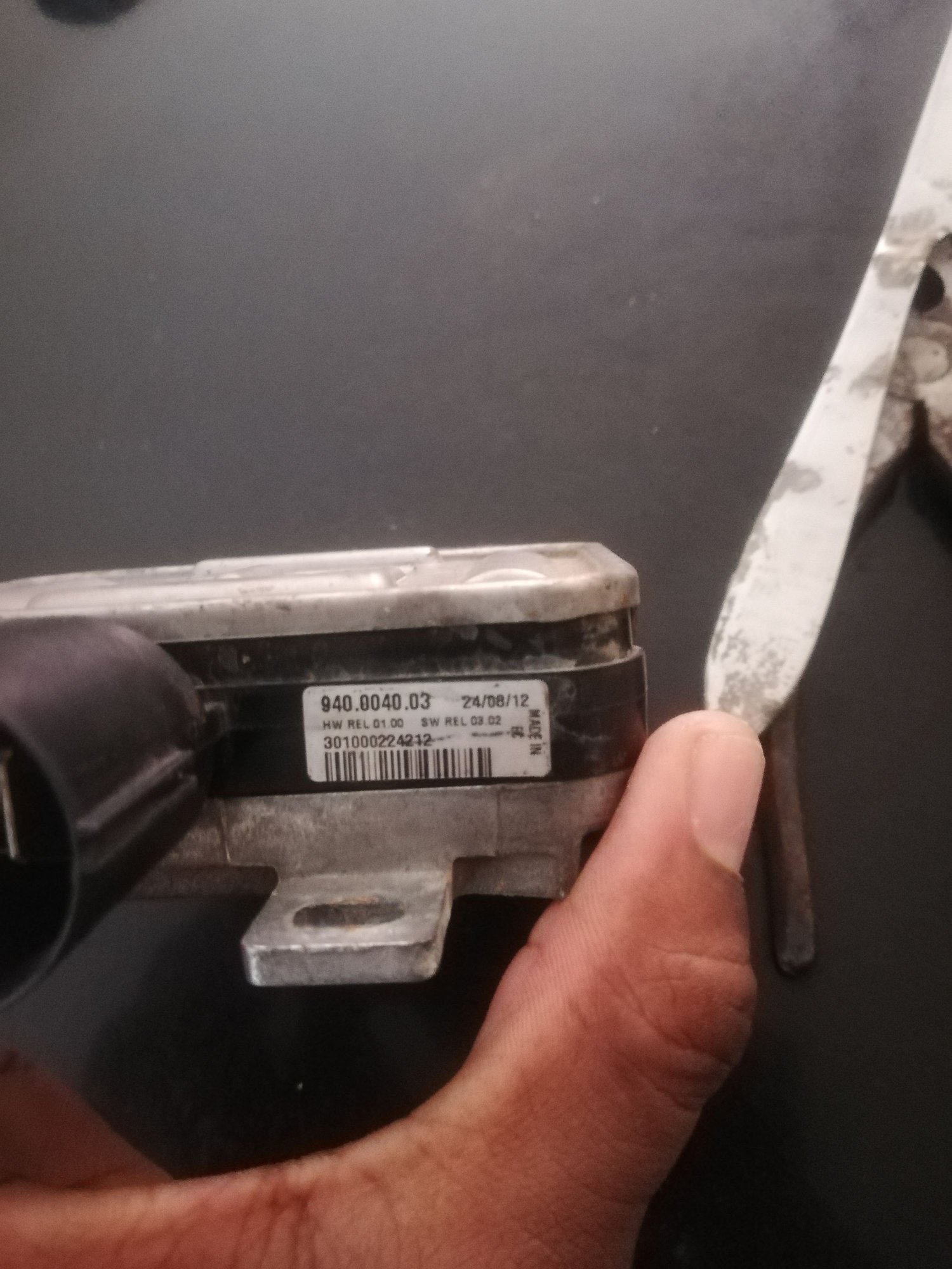

keleb, I looked up the part number. That should be a good unit to buy. I guess I have to ask "when did you buy it?". If you just bought it and installed it, then it should have a warrantee on it and you should be able to get a new unit. If you have had it installed for a few years. probably not. if you got a few years out of it, then odds are that was about its life. I have seen people have to replace these every few years. This is especially true if you like to run the A/C at full blast to keep the inside of the car ice cold (this makes the fans run at max speed and therefore fries the electronics).
I shall find a replacement, it was the first time since 2007. So it haa reached it's life. Thanks a lot. I will use it to learn
