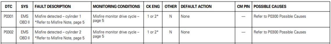

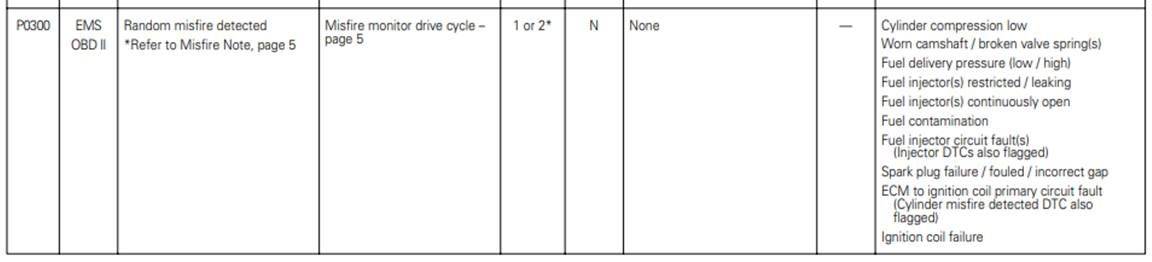

A failing fuel pump can cause misfire codes. I learned this the hard way after replacing coils and plugs and still having misfires until the day the fuel pump totally died.
From the OBD code manual for the X Type:
