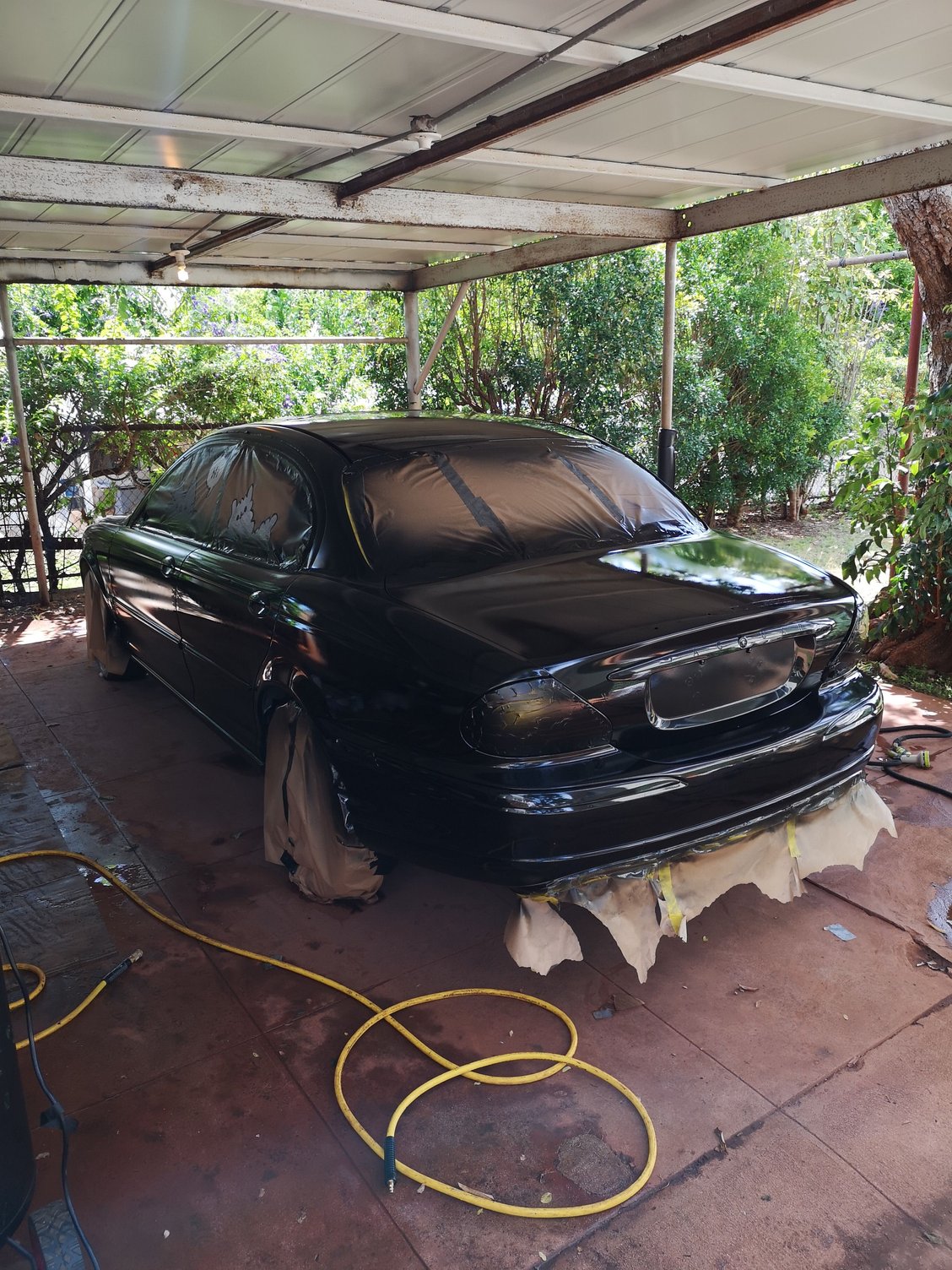

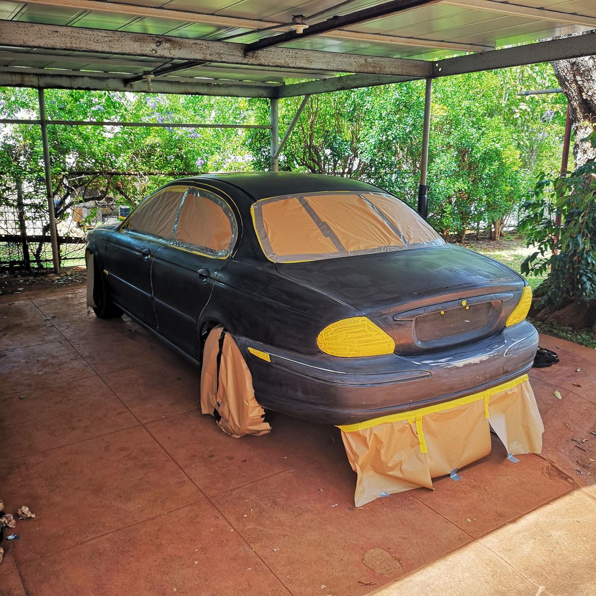

Paint went on the car yesterday. I'm pretty pleased with the results given it was my first time painting a whole car and done in my duty carport with very substandard equipment. I think with a wet sand and buff it should look pretty nice. There are unfortunately quite a few scratches and marks that are showing through on the hood. I really should have done a fuller prep job on it, but I mostly did this as a learning experience since the car could never justify a professional job and it certainly looks much better than it did.

XTypeHI, ah, the joys of painting in the hawaii weather. I helped out a friend that messed up the fender and trunk on his car. I ended up repainting them for him. Once trick I learned during that was that you can do some wet sanding on the spots that have scratches that show through and then just spray right over where you sanded. Worst case, you can redo say the whole door or whole hood, but in reality, thin the paint down a little bit and just cover a little bit beyond where you sanded and all should be good. Save you some time and will get rid of those spots that are bugging you.
By the way, are you using a 2 part or 1 part paint system. From the looks of things, you are doing a 1 part paint system. makes things a little more difficult for what I mentioned, but still doable. I am surprised you left the tail lights in the car. 3 nuts for each and a plug, they would have came out. Took you longer to tape them up than it would have to remove them. But, too late now.

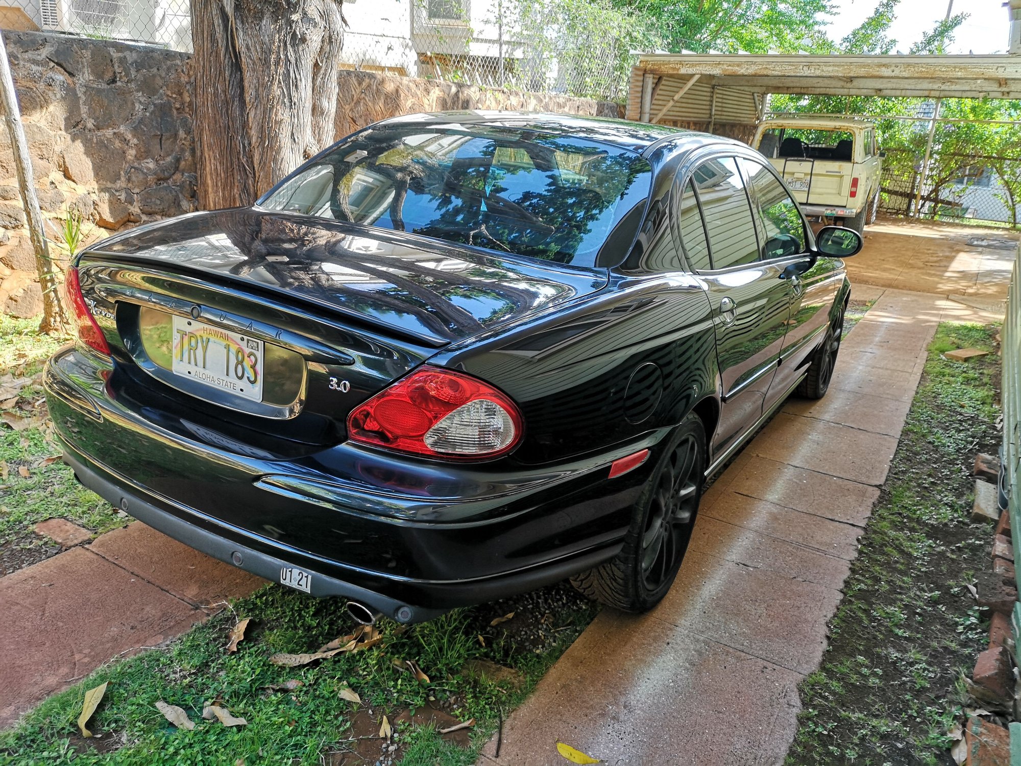

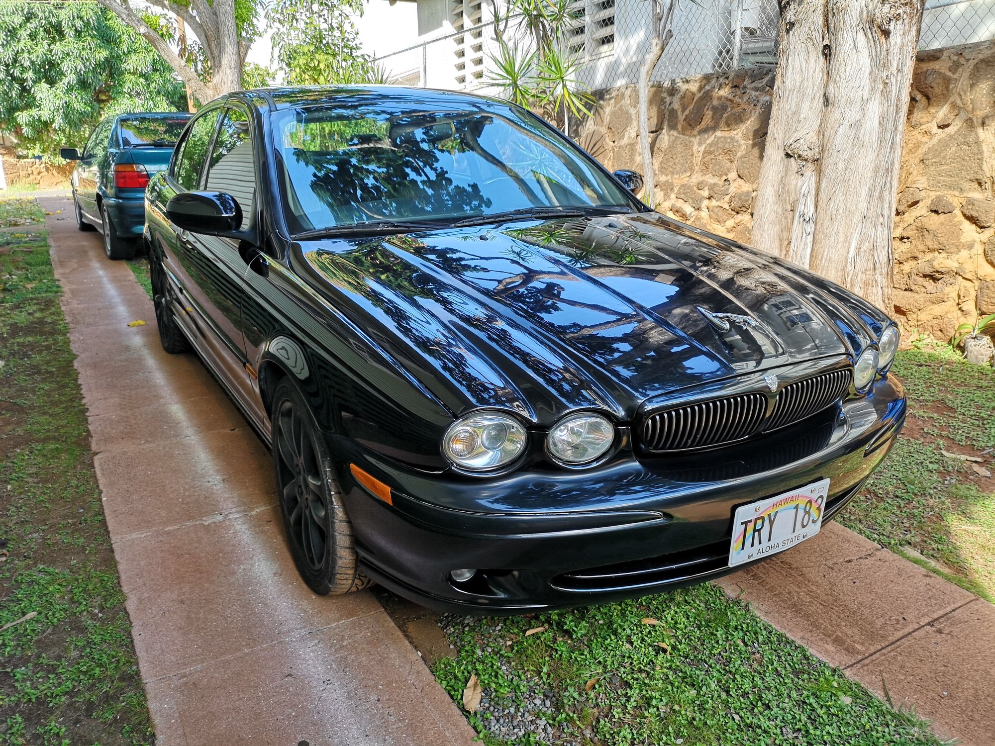

Paint work is all done. Wet sanding and buffing took several full days and was a lot of work, but it was necessary for a quality job as there was a lot of orange peel along with some dust and dry looking spots. There are a few things I would have done differently, I would have fully stripped and re-done the hood and done a multi-stage buffing job starting with a more aggressive pad and compound as some sanding marks show in certain lighting conditions and angles - black paint really shows everything, but overall I'm happy with the job. I didn't know what to expect as it was my first paint job, but I think it shows a quality job can be done at home on a budget if you're willing to put the time and effort to wet sand and buff.
